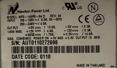

The PSU has 4 molex connectors, 1 floppy connector
I've attached a photo of the PSU specs. The stock PSU specs are:
744.25 KiB
118 views
PSU Specs
145W Maximum Output
+5V - 13A
-5V - 0.3A
+12V - 4.0A
-12V - 0.3A
+3.3 - 14A
+5VSB - 1.7A

Using the stock PSU I need to split 2 of the molex connectors to plug everything in.
1 Molex would be split into 2 molex adapters to power the HDD Clicker, and the Zip Drive.
Another Molex would be split into 2 floppy power adapters, to power the CF Card Adapter & the Gotek Floppy Emulator.
I'm afraid this PSU won't be sufficient for the planned build. I have most of the parts, but I'm still have a few parts left to pick up.
Looking for some advice on if the stock PSU will be sufficient, or if I need to get a new PSU.

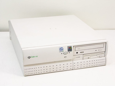

If I need a new PSU it's going to need to be a small form factor, or a PICO PSU, or something similar. Can anyone recommend something that would be a good fit for this planned build?
I've attached a photo of the style of case.

Reply 1 of 1, by Doornkaat
Hi! Given the PSU has only got 13A on +5V it is at least probable this setup will overload it.
Mainboards of this generation usually take +5V as their main supply voltage and generate all voltages from that. Some will use +3.3V from the PSU for powering RAM, for delivering +3.3V on AGP/PCI and for signalling voltages but +3.3V is also often generated from +5V on the motherboard.
+12V is typically only used for motors (drives and fans) on this generation of mainboard.
If we assume this board uses +5V for everything the motherboard itself probably requires around 2-3A, each stick of RAM is roughly another 1A, and the CPU with its TDP of 29W (peak power consumption is higher!) will add another 6-7A including VRM losses. This means worst case we're already close to the PSU limit without any other components.😐
PicoPSU won't do you a lot of good because it hasn't got a lot of +5V power either. Those focus on modern systems that rely mostly on +12V.
What measurements does the original PSU have? It does not look like it adheres to any standard but maybe an adaptor plate can be made?
