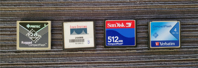

For CF cards I tend to use a few different brands. I favor either industrial-branded cards (e.g. Cisco), standard Sandisk cards or Verbatim, the latter of which are available in 2GB and 4GB from Amazon. Attached is a picture of a handful of cards I'm currently actively using in various builds. The 512MB card specifically I purchased from Ebay as a new-old-stock item.
Now in terms of size, on a 486 system (and earlier) you might into BIOS limits with respect to the size of the HD it will detect. This is why I use a 512 MB card in my 486 system, since the BIOS on my system only supports up to 504MB in drive size.
There are ways around this limitation via Dynamic Drive Overlay (DDO) software, but I haven't bothered with that personally. I find 500MB is perfectly usable on a 486-era machine.
