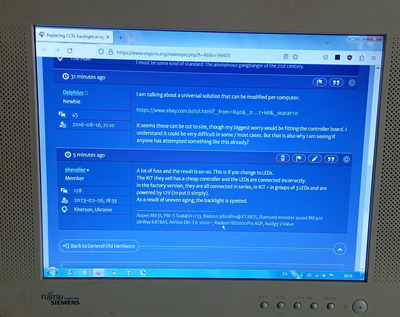

Reply 3 of 15, by shevalier
A lot of fuss and the result is so-so. This is if you change to LEDs.
The KIT they sell has a cheap controller and the LEDs are connected incorrectly.
In the factory version, they are all connected in series, in KIT - in groups of 3 LEDs and are powered by 12V (to put it simply).
As a result of uneven aging, the backlight is spotted.
PS.
Siemens 3816FA, just not so yellow, like my.
And then, I had to redo the native CCFL driver to drive the LEDs. For the one being sold - is a piece of garbage.
    1.37 MiB
    428 views

Reply 5 of 15, by shevalier
Nope, It`s a cut 2 times and it once touched with a soldering iron.
"it's a good amount of work"
- completely disassemble the monitor
- completely disassemble the matrix
- glued the LEDs string to the reflector
- assemble the matrix
- detect dust between the layers of the assembled matrix
- repeat disassembly/assembly
- disable CCFL driver
- find the connection points for control signals - enable and brightness
- screw the LED driver somewhere
- assemble the monitor
- detect LED driver flickering
- detect that the gamut has left (completely different colors)
- detect uneven glow of the screen surface
- detect that the brightness adjustment limits are very strange
- (non)profit
CCFl is better to change to CCFl, from my experience.

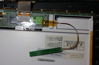

Reply 15 of 15, by Thermalwrong
It depends when the laptop was made and what kind of system it already uses to control brightness. 90s Toshibas don't really have much to control backlight brightness, just one kind of high/low setting. When I upgraded a laptop from DSTN to TFT, I also upgraded it to an LED backlight. One neat thing is that it uses the contrast adjust wheel to adjust the brightness now instead. That one had to be upgraded to LED to even fit since the LCD is out of a TV and just barely fits in the screen housing after dremeling 😀
The LED backlighting is far brighter than the CCFL so it's kind of like you can adjust it once while building it using an adjustable resistor to 5v. On laptops that have it though, you could probably re-use the brightness slider.
Something to be aware of is that even though the LEDs are usually a warm-ish white, they're not as 'warm' as CCFLs so the screen can sometimes be more 'blue' tone than the original backlight.
The older Toshibas you will need to add in a step-up voltage converter since they run the backlight from 5v. I'm not sure how it is on other brands like IBM in the 90s era though.
Upgrading my Thinkpad 240 to an LED backlight was mostly a drop-in replacement once I worked out what the Enable and Adjust signals were - that's from ~1999 and is kind of an Acer / IBM hybrid thinkpad. The enable & adjust signals match up with the LED backlight driver board I used and the inverter power supply was the right voltage, so the LED driver drops in where the inverter once was and the brightness adjustment works properly.
Something to consider with current cheapy LED retrofit kits is that they use a row of individual LEDs rather than many smaller lights like you can get with CoB rope lights now. On the 240 it's a quite slim LCD panel that uses a thin CCFL, when I put the LED backlight strip in it had lots of points of light which just seems to happen with some LCD panels. Fixed that by putting in some extra fresnel sheets from a broken LCD panel.
450.26 KiB
234 views
It's random chance though, I upgraded my Portege 3010CT to LED backlight and that's maybe thinner than the Thinkpad 240's LCD but it doesn't have the bright spots problem at all.
Enable signal - allows the inverter to be powered but disables the output. Used to avoid displaying a blank white screen if the backlight powers up before the LCD panel begins displaying. Off when at 0v.
Adjust signal - an analogue voltage signal that ranges between ~2 to 5v with 5v being dimmest and 0v being brightest. The LED drivers I use are pretty dumb and will happily run the LEDs beyond a safe current if the adjust signal is wrong. This seems to be fairly standardised after a certain point, kind of. later Thinkpads use PWM instead apparently.
I think that the LEDs showing up as points can be a fairly common complaint with these retrofits. Mostly with the older laptops like 10.4" to 12.1" from 1995 - 1999 the screens seem to work quite well with the individual LEDs instead of the CCFL without that spotlight effect. In the older laptops it should be easier overall, the CCFLs are often bigger and designed for replacement. More room to work with as well.
If anyone wants to try out an LED retrofit then I could give some pointers, I've upgraded all the ones I intend to for now.
