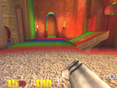

However, in the trilinear texturing test and the two “game” tests, the TNT2 pulls ahead. A 4% win for the TNT2 in trilinear texturing, a 15% lead in “game 1” and a 23% lead in “game 2” for the TNT2.
TNT2 can't do trilinear filtering. Well, it technically can, but you'll have to drop fillrate by half or multitexturing, so Nvidia disabled that feature, just like 3dfx did. TNT family can do trilinear approximation instead, which is also called mipmap dithering. It's faster, but uglier. GeForce 2 MX can do proper trilinear filtering and will suffer considerable penalty for that.
Here's how it looks on Voodoo 5 (courtesy of ixbt.com):
The attachment v5_q3_tlf.jpg is no longer available
TNT has similar dithering pattern.
