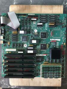

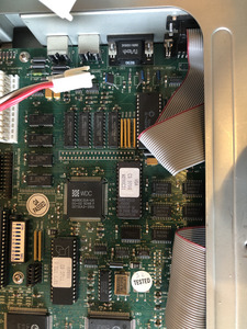

I got this 486 today but I don’t know much about it. It‘s a weird PC with a PS/2 mouse AND keyboard connector. There was no cdrom drive, only a 3.5“ and a 5.25“ floppy drive. The harddisk is a seagate ST3120A with 107MB. I only connected the HDD to test the PSU and I got 5V so I guess that‘s OK for now.

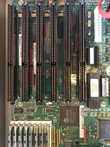

The mainboard has an onboard WD90C31A graphics chip.

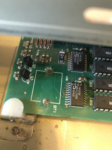

The barrel battery was just starting to leak and was removed just in time it seems. I still need to remove the board from the case, so there may be a nasty surprise waiting for me…

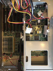

I don‘t know what CPU is installed because the ZIF socket has this u-shaped lever that gets blocked by the heatsink - clever! 🥳
I‘m going to clean up the corrosion and de-solder the battery pins. Good thing the board has an external battery connector!
Well, maybe someone recognizes this board?

I was going to say PCB looks very ACER like and then I saw AMBRA on BIOS chip 😀 Its one of IBM value sub brands outsourced to ACER
https://www.youtube.com/watch?v=4HjqQr177q4 AMBRA: The Forgotten PC Brand from IBM The Serial Port
https://www.youtube.com/watch?v=vapy4916iUA IBM's Ambra, What Went Wrong? Dinty's Hideaway
Edit: might be Ambra Hurdla 486. Cant find any pictures of one inside, but all the others dont fit

I also discovered the story behind Ambra. Still haven’t found the manual for this particular board/pc but I don’t think I‘ll need it.

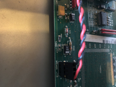

I removed the board and it appears (looking at the jumpers) it has 256kB cache and a 486DX50 cpu installed. Now I just have to add a soundcard and probably a CF adapter and the PC is good to go.
My only ISA soundcard left is an Aztech PnP but it has an OPL3 so I guess that’s ok for Dos6.22.
