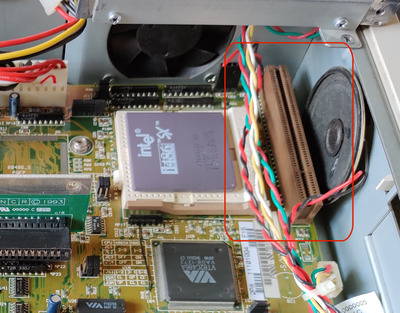

So i've gone back to playing with my 486 Pizza Box PC, a Globalyst 510 with an FIC 486-GAC-2 motherboard.
As a few people on this forum are aware, this board has a proprietary cache module slot, that resembles a VLB connector.
So far, no one who has mentioned they have been looking for cache modules for this board, has found one that works, at best, they fit but are not compatible.

This page has a Globalyst 510 in testing, and shows a cache module.
https://www.high-voltage.cz/2018/globalyst-51 … kolo-vylepseni/
From what I can make out from the pictures, I think it says:
MODEL: CACHE MODULE
DOC: 13630
Only the labels of two chips can be read, and one (tag?) is covered by a sticker.
I have searched eBay countless times with that ID, and never turned up anything.
Heck, If we could even get detailed pictures of both sides of a known working module, it might lead to possibilities regarding creating a reproduction.

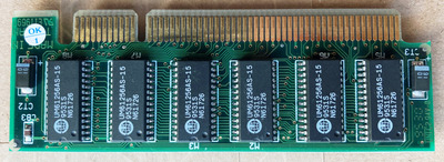

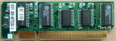

Reply 1 of 10, by majestyk
I own only one of these modules. It´s a 256K L2 cache module with integrated buffer circuits and a proprietary pinout.
1.26 MiB
493 views
1.28 MiB
493 views
636.12 KiB
119 views
556.7 KiB
119 views
To make things worse, FIC sold two different versions with different pinouts (and the same "VLB"-socket). Only the one in the pictures works on a 486-GAC2 and a few other FIC mainboards.

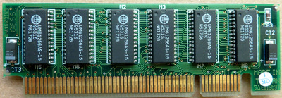

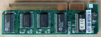

Reply 3 of 10, by RockstarRunner
As difficult as the task may be, I have started to map the traces from the pictures you provided, at least those that don't end somewhere under a chip.
@majestyk
Would you be able to take a few more pictures, some sightly angled maybe, to make the shadowed areas clearer?
And do you have a multimeter?
Once I've mapped everything I am able to, it would be greatly beneficial if you could confirm my findings, and help map the traces that are under the chips.
I've discussed this with my electronics expert friend, and he doesn't see any reason a repro can't be made, with some effort.
Reply 4 of 10, by majestyk
I will take some more detailed pictures.
I could also could do some measuring to identify the ground and Vcc pins and check for continuity between all the I/O, address, CS, CE pins at each SRAM and buffer chip and the pins of the "VLB"-socket.
This will probably not reveal all the information like the number of layers, or traces that connect chips with each other.

Reply 9 of 10, by majestyk
I added two pictures above after cleaning the stick.
rasz_pl, do VT82C486A and VT82C496G share the same pinout?
I have most of the FIC mainboards with this chipset here, so I could do the measuring. The two 244 buffer chips are on the cache-stick here - we need to measure between the chipset and the buffer inputs in this case.
