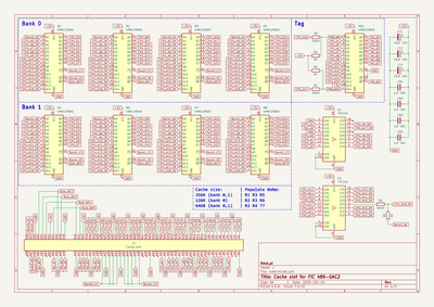

rasz_pl wrote on 2024-02-08, 06:42:
Majestyk could you please check some things for me? - U1 2? I have no idea where it could be connected to - U1 3 to M1 5? - U1 7 […]
- U1 3 to M1 5?
- U1 7 to M1 7?
- U1 9 to M1 8?
- U1 14 to M1 26? is it connected to VIA right above U1?
- U1 16 to M1 9?
- are all M1-M8 pin 10s connected together? This doesnt make sense logically, I have a feeling it should be split into groups M1-M4 and M5-M8.
- U1 18 to M1 10 or M5 10?
- U2 12 to m1 4? is it connected to VIA right above U2?
- U2 14 to M1 3?
- U2 16 to M1 25?
-cache slot a28 a30-a32 to a56 or a57? I wonder why so many connections bundled together
-cache slot a34-a36 a38 to a57 or a56? I wonder why so many connections bundled together
-cache slot a56 to M8 20?
-cache slot a57 to M4 20?
-cache slot b57 to M8 22?
-cache slot b58 to M3 22?
-cache slot b55 to M8 M4 27?
-cache slot b54 to M7 M3 27?
-cache slot b53 to M6 M2 27?
-cache slot b51 to M5 M1 27?
I will try my best - tomorrow.
Reply 42 of 121, by majestyk
- U1 2? I have no idea where it could be connected to? -> Vss
- U1 3 to M1 5? -> yes!
- U1 7 to M1 7? -> yes!
- U1 9 to M1 8? -> yes!
- U1 14 to M1 26? is it connected to VIA right above U1? -> 2 x yes!
- U1 16 to M1 9? -> yes!
- are all M1-M8 pin 10s connected together? This doesnt make sense logically, I have a feeling it should be split into groups M1-M4 and M5-M8. -> the latter, M1-M4 and M5-M8
- U1 18 to M1 10 or M5 10? -> This seems like N/C, I can neither find a connection to any of the chips nor to the edge connector. And this makes sense, since pin 18 is I0-output, while the (grounded) pin 2 is I0-input. Buffer 0 is unused.
- U2 12 to m1 4? is it connected to VIA right above U2? -> 2 x yes!
- U2 14 to M1 3? -> yes!
- U2 16 to M1 25? -> yes!
-cache slot a28 a30-a32 to a56 or a57? I wonder why so many connections bundled together -> no conn. to a56 or a57
-cache slot a34-a36 a38 to a57 or a56? I wonder why so many connections bundled together -> no conn. to a57 or a56
So far I could not detect any connections from these two groups to any of the chips, but I will take a closer look tomorrow
-cache slot a56 to M8 20? -> M8 pin 10 (A0)
-cache slot a57 to M4 20? -> M4 pin 10 (A0)
-cache slot b57 to M8 22? -> yes!
-cache slot b58 to M3 22? -> yes!
-cache slot b55 to M8 M4 27? -> yes!
-cache slot b54 to M7 M3 27? -> yes!
-cache slot b53 to M6 M2 27? -> yes!
-cache slot b51 to M5 M1 27? -> yes!

Reply 43 of 121, by majestyk
On the mainboard side the connected pins a28, a30-a32 go to R23 (22R) and from there to pin 204 of the VIA VT82C486A.
The connected group a34-a36, a38 goes to R16 (22R) and from there to pin 7 of the VT82C486A.
On the cache stick
pins a28, a30-a32 are connected to M5 pin 20 (CE)
pins a34-a36, a38 are connected to M1 pin 20 (CE)
I have no idea why they used 4(!) contacts in parallel for each of the lines...
I also found that the system is unable to share the 8 TAG-bits for TAG and dirty/alt.
BIOS has an entry where you can select "combine alter and TAG bits" to enable/disable, but the result is the same - CTCM reports "Dirty TAG L2 -> n/a" and the memory performance is the same for "if dirty" and "if clean".

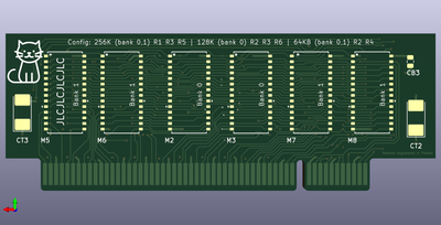

Reply 44 of 121, by rasz_pl
I had long reply typed in while fixing footprints, forgot about it and refreshed the page 🙁 Lets try again:
majestyk wrote on 2024-02-09, 19:44:
yes!
Wow, thats a lot of yes 😀
majestyk wrote on 2024-02-10, 08:06:
I do, they use one pin per driven chip as a provision for multiple separate drivers. The same thing happens with Byte_WE0 - Byte_WE3, those signals go to pairs of M1-M5 M2-M6 M3-M7 M4-M8, two chips two tracks. On the face of it its useless as there is no benefit from giving yourself ability to write 1 byte to Bank0 and 3 bytes to Bank1 in one cycle, but I guess someone decided to better be safe than sorry?
CE pins are common per Bank of four SRAMs so four tracks driving them. I already had CE tracks routed to meet those pin groups in last update as seen in FIC 486-GAC-2 cache coast VIP 95%.png blue text under under_U1_2 under_U1_3 😀 just needed confirmation.
would be cool to locate 'alter' input of VT82C486A
yep
cool, this is Bank0_A0 and Bank1_A0
Progress report before your last post confirming CE pins was
"ERC 2 errors 0 warnings, DRC 0 errors 4 warnings"
After finalizing CE:
"ERC 0 errors 0 warnings, DRC 0 errors 1 warning"
One last unknown was A7 going from a18 to U1 pin 15 but also between pins 13 and 14. I looked at it harder and it finally hit me, its going around to avoid having to skip over A17_SR with a via under U1.
"ERC 0 errors 0 warnings, DRC 0 errors 0 warning"
We are all green across the board! Footprints should be correct now, but better to print on paper, cut out and try if it lines up in the slot 😀 Its not 100% 1:1, I think original uses slim SOJ footprint, plus I made module slightly taller and fixing it now for 2 mm of difference would be a ton of work. Still needs some silkscreen work. Im still not 100% sure 64K R2 R4 configuration is a real thing 😀 needs testing. No chamfering a that requires Enig. Jlc does weakass goldplating and its stupid expensive + requires 5cmx5cm minimum board size (probably for holding boards while routing, we are smaller on one size) https://jlcpcb.com/quote/pcbOrderFaq/Gold%20Fingers
RockstarRunner you will have to use a nail file to slightly cut edges of the connector. Should be $7 + shipping for 5 boards
9 brand new SRAMs $13 https://www.digikey.com/en/products/detail/is … L-12JLI/1555403
2x 74F244 $2
3x 10uf $1 https://www.digikey.com/en/products/detail/ta … 106MLHT/6563099
4x 1uf $1 https://www.digikey.com/en/products/detail/ta … 05KGHTR/6563151
$24 total. Sadly those parts arent on the JLCPCB Basic List, nor even in stock as extended at the moment, maybe you can mail them and ask what it takes to pre-order - JLC assembly would be even cheaper than buying components from digikey. I know you offered to send me one, but I really dont need it. Ill gladly take some junk instead 😀 ISA MFM HDD controller or few 5.25 floppy disks, we can talk if the module works 😀
Other than that it was a fun ride, hope it works, needs some eyes on it checking for silly mistakes.
155.44 KiB
449 views
GPL-2.0-or-later
PS: found two other boards reusing VLB slot for proprietary cache, both totally different Re: Cache and video memory upgrade questions - HP Vectra VE 4/66
Reply 46 of 121, by rasz_pl
RockstarRunner wrote on 2024-02-10, 21:51:
Well done, rasz, seriously! 😎
So, next step is putting together a prototype, I'll get on that tomorrow.
Next step is you or majestyk printing sram.kicad_pcb on paper in 1:1 scale, cutting it out with scissors and checking slot fitment and pin alignment (both slot and chip footprints). Would be good if you went over pcb comparing it to your photoshop traces one track at a time looking for mistakes, and going one more time over motherboard cache slot with a multimeter confirming ground/power pins just in case. Re-checking is quicker and cheaper than multiple board re-spins, its only $7 if you do it right on the first try 😀, little mistakes add up quickly.
Ill also go over the tracks one more time to space it all out better and slap some silkscreen. Final result:
133.82 KiB
402 views
139.58 KiB
402 views
Link to github repo https://github.com/raszpl/FIC-486-GAC-2-Cache-Module

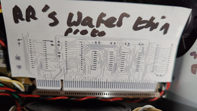

Reply 47 of 121, by RockstarRunner
First step of prototype was going to be paper version, like you said 👍
I live in Europe, so nothing about getting parts and pcb's will be cheap, and shipping costs + taxes etc.
Anyway; I have the chips, buffers and caps ordered, and I'll get the pcb design printed on paper when I visit my friend this evening, so I should have an idea if it fits by the end of the day.

Reply 50 of 121, by RockstarRunner
New advances in technology now allow wafer thin prototype cache modules 😉
1.21 MiB
338 views
Wafer thin
Scale was checked using a SOJ20 chip that although has less legs, has same pitch as the correct SRAM chips, and it lined up perfectly.
Looks ok to me

Reply 52 of 121, by rasz_pl
does it fit fine in the slot? all the way in?
Please do your photoshop magic once again and check if I didnt do any obvious stupid mistakes 😀
gerbers https://github.com/raszpl/FIC-486-GAC-2-Cache … e%20gerbers.zip
When ordering upload gerber and select "Remove Order Number: Specify a location", this will order 5 copies for $7 + shipping around $2-8 for standard land two week fare.

majestyk wrote on 2024-02-11, 19:38:
P.S.- I still don´t understand the "4-contact thing". I mean, the 4 pins are shorted at the mainboard socket and they are shorted on the cache stick right at the goldfingers. The only purpose I can imagine would be to reduce resistance, but there´s already a 22R resistor in the CE line, so this will improve nothing.
Person designing Cache socket pinout in the first place made a provision for driving all SRAM CE and WE pins individually, just in case I guess. In theory it would allow for some weird access patterns. Im sure it made some sense at the time. I wonder if a3 a2 or a23 are connected to anything on the motherboard side. Maybe it would be possible to make 512-1024KB cache 😀
Reply 55 of 121, by majestyk

Reply 56 of 121, by rasz_pl
majestyk wrote on 2024-02-12, 07:14:
Shame on me
Gave me an excuse to exercise disassembly skills 😀 Two years ago it would have taken me hours, but now I was already reading this code after ~10 minutes.
With 32MB it´s all perfect.
what big of a difference does it make in cachechk? Have you considered experimenting with jumpers on cache module to mod it down to 128/64KB?
Sadly a2, a3 and a23 are N/C on the mobo...
There is still sliver of a chance FIC chose to never offer 512-1024 modules but chipset support is still there.
EDIT: Got an epiphany while sitting on the throne :] Above code from Bios 3276gn1 already checks for 32/64/128GB when disabling Alter bit, this only makes sense if you support 1MB L2. Means its either universal code module common for all VIA chipsets at the time (like VIA_82C496G), or VT82C486A supported 1M L2 from the start.
Hmmm, this would require wiring A18 A19 straight from chipset/VLB slot to cache module, and different module of course, too much work for small gain 😀.
Btw Alter bit is only supported by stealing TAG bit, no separate Alter input in the chipset 🙁
Reply 57 of 121, by RockstarRunner
"Hmmm, this would require wiring A18 A19 straight from chipset/VLB slot to cache module, and different module of course, too much work for small gain"
This is great discussion though, while waiting for parts to build the prototype, but bit over my head.

1 "Necroware did I get that right: you found a module that would be electricaly compatible to your board, but mechanically too high to fit under the floppy drive"
erm, I made the reproduction slightly taller 😮 RockstarRunner did you check if paper cutout fits under the floppy? 😁
2 RetroSpector78 also got Globalyst 575 system, its another similar but not exact same board with VLB cache slot https://stason.org/TULARC/pc/motherboards/A/A … BALYST-550.html
3 RockstarRunner if the module works you will be able to sell of at least one pcb to Necroware 😀 Im sure he would love to solder it on video.
