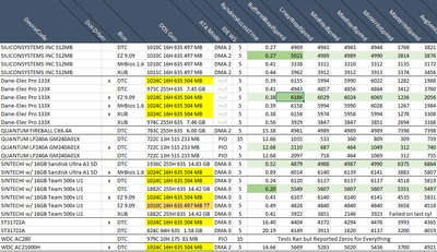

I focused on the WinTech board with the Lion 3 card yesterday
Two discoveries about the LION 3+ card :
1) I have rarely been able to go faster than 6MB/s with the controller jumpered to 5ws for the IDE device (fastest setting) and a 33MHz VL bus.
2) The Lion 3 driver is a little faster but while it detects large storage, it only reports up to 8.4GB capacity when initializing the device (the ECHS limit), and only lets DOS see up to 1024C/16H/63S (528MB CHS limit).
Looking through the driver binary, I see there's an "incorrect switches" string, but I can't see any help page that indicates what switches are available. The driver isn't all that useful at this point.
Here are the drives that I used:

Here are the results I collected:

Notes:
  • I wasn't able to match the high benchmarks that I saw on the SILICONSYSTEMS CF Tuesday evening. Don't know what changed. I messed with the device a lot Wed morning trying to get Ontrack to work with it, formatting it a couple times. Ontrack was fussy and never loaded on the drive.
  • The WD Caviar 80 only worked with high waitstates, and even then it was iffy
  • Could not get my 6.4GB Quantum Fireball LCT to work with this controller
  • Could not get my 211MB 3600RMP ST1239a to work either. Clanged like it was having LBA issues regardless of the BIOS
  • I'm going to swap out on of the fast 16GB SD's for something smaller and slower when it arrives.
Let me know if there's any tests you want to see with the LION, otherwise I'll move along to another controller.

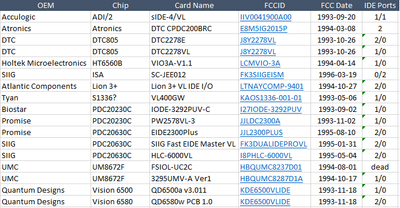

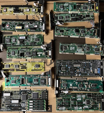

Here's the armada of VLB controllers that I've collected:

Sorry about ruining the market for < $40 VLB controllers on ebay. They'll come back in a few months.

I wanted to do the read/write hard drive tests. In the past, I had worked with a newer board that had two IDE channels, so I just always benchmarked on the second channel.
This was a little trickier, because not all of the controllers had a second channel, some of the second channels were on ISA, and I didn't want to mess with trying to jumper all of the test drives to be slaves and deal will a bunch of unknowns.
My solution was just to run speedsys from A: and use the report options to dump the info to the A:
Then I take that to another computer, parse the output with powershell and put the results a SQL database.
