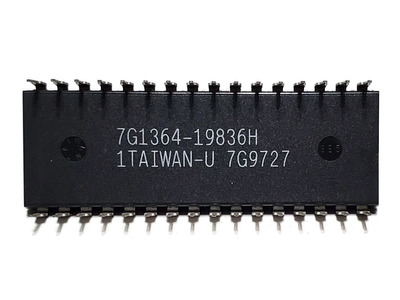

XGecu T48 has arrived, however the numbers on the bottom of the chip don't seem to come up in its database. Sticker says PCI/PNP 586 and shows a serial number, nothing underneath it. Socket on the motherboard says 27010.
    123.05 KiB
    1308 views
Yeah, also noticed that the silkscreen print says 27010, which is kind of funny. A 27 series (E)EPROM wouldn't work at all since the pinout is completely different from the 1Mbit 29 series EEPROM the board expects 😀

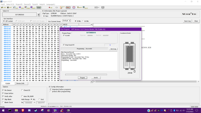

My board specifically used an SST29EE010. The make/model can be found on top under the BIOS hologram label, but if you don't want to remove it, you can use the profile for any 5V 29 series 1 Mbit EEPROM in XGPro if you skip the ID check. I'd suggest that you try the SST29EE010 profile, and if your board is using another model and fails the check, just untick the "ID check" box in the lower left corner before trying again.
As a sidenote, you might also be interested in Xgecu's official programmer software/firmware update channel here if you haven't found it already.

Nothing under the hologram label except for another small sticker that says 5HX. It does give an ID check error but if you're sure it will work, I'll do a test read and try flashing one of the BIOS ROMs you posted!

Yeah. As long as it passes verification after programming, you're good to go 😀

kahlil88 wrote on 2023-07-12, 07:13:
Started playing around some in Xgpro and found Read ID under the Device menu. Maybe you can find your chip in this list and identify it that way? 😀

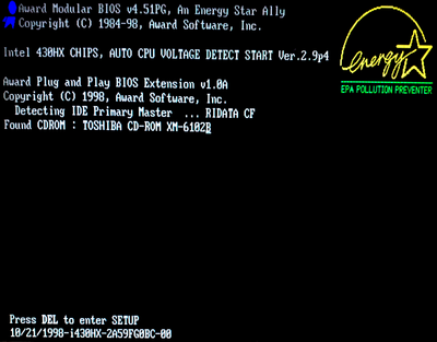

Wasn't quite sure which file to use for the MR BIOS so I flashed the other and it's alive! I did end up flashing it via floppy but now it won't boot my CF card. Oh well, nothing wrong with the original BIOS (except that eyesore EPA logo)
Thanks for the list! ID check says 1FD5 (Atmel AT29C010A)

That's probably a question of settings. I'd just load the setup defaults and reconfigure the BIOS from scratch if I were you 😀
Oh, and you can replace or remove the EPA logo with CBROM if you like. There are also 3rd party GUI editors that should be able to do the job.

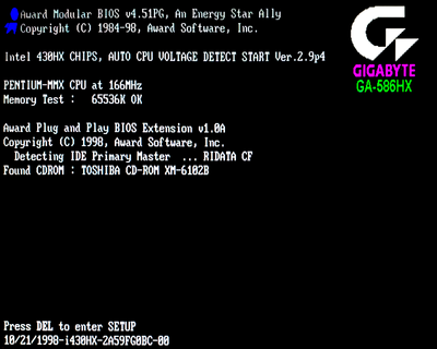

I made a nice custom Gigabyte logo and thought I'd share
