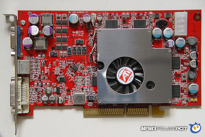

Everything is fine there with the pairing of die and cooler.
There is exactly one problem - the lack of temperature monitoring.
Because of this, users did not raise their fuss about overheating, and all manufacturers installed a frankly insufficient cooler.
The card consumes over 50 W, so the manufacturers were forced to put a normal turbine for XT on the new revision of the board with LM63.
There is also a 9800Pro on a 9800XT board, but without turbine fan.
Whether it has temperature monitoring - I do not know.
https://archive.techarp.com/article/ATI/Radeo … d/256mb_new.jpg

The metal shim around the GPU die expanding faster under heat load and with repeated heating/cooling cycles separating from the die and lifting the cooler off the GPU die is the cause of the problem. Monitoring may have helped identify the overheating but it took a revision by ATI for later model 9800 cards to mostly fix the problem, the revision also included a better/bigger cooler with the retention brace. (Some 9700 series cards also got this revision and new cooler) IIRC the 9800 also has a thinner shim around the GPU die than the one on the 9700 Pro.
ATI knew about the problem back in the day because a large number of people were reporting the problem including a number of tech news groups so it wasn't that users were not making a fuss, they certainly did.
As for other manufacturers not using bigger coolers initially, I guess they take their guidance from ATI who obviously got it wrong.
IIRC any 9800/9600XT that uses the LM63 chip should be able to monitor temps but there was no 9700 Pro that could do this.

Some coolers were specifically designed to circumvent this issue. Most haven't : they have a "flat" back.
I moded my 9700 Pro with a thin piece of metal between the die and the cooler.
Just a simple piece of metal, cut with an angle grinder and super polished with fine grain sandpaper. Thermal grease on both sides + the original cooler on the top.
I have four 9700Pro and just one working. I really don't want to damage it.
I confirm for the temperature readings. I can't read them on mine. GPU-Z only reports frequencies
I didn't notice, there's quite a big clearance, I think.
But the stock Intel cooler from P3 and 2 self-tapping screws turned out to be much better.
Trashbytes wrote on 2023-06-29, 10:10:
acl wrote on 2023-06-29, 10:24:
The older design 9800 pro has traces on the PCB to adjust the fan speed. Apparently, this is some kind of primitive analog circuit on an operational amplifier.
But given the heating with the stock cooler, it was abandoned because of the senselessness.
