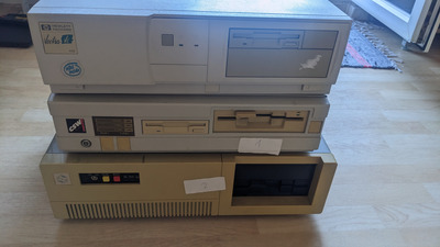

I got myself an Turbo XT clone system. Other that it is (was) dusty and grubby it seems to work. I cleaned it thoroughly and am now in the process of reassembly. The no name MFM controller card does not have an header for the HDD activity LED. The ST-225 drive is mounted in a way that it does not have a drive bay cover with LED cutout. Instead the case has an HDD LED. The LED cable was snipped some time. There must be a way of connecting the LED to the drive, but how? Looking closely I can see some solder work on one pin of the ribbon cable connector, but according to https://en.wikipedia.org/wiki/ST506/ST412#Connector_pinouts this pin is only a GND pin. Next to pin 16 there is also solder work, but I dont want to connect anything without knowing what to do.
