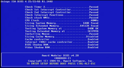

I purchased this Unisys server during the pandemic and trying to push it to its limits. I would blame Halt and Catch Fire. It was small and had a SCSI interface and a 8 UART serial card. When I booted it up, it ran SCO Unixware with two drives that were very, very loud. I was planning on rooting the box and playing around with it, but I've already done a lot of Unix systems and a 486 is a bit limiting compared to what I am used to.
I upgraded the CPU to a DX66, as the BIOS boot screen shows support for it. I haven't been able to get it to clock over 40Mhz, but it is very stable. The RAM has been maxed out to 64 MiB. I preferred to use the SCSI to boot, but that has me limited to 1GB. I have made many attempts to get a drive > 1GB and the BIOS won't do it. Even IDE with a real card and BIOS is not stable over 1GB with spinning disk or solid-state with adapters. This includes attempts at SCSI2SD. What is stable is using the first 1GB of an 8GB SCSI drive. It is a 68pin drive (Seagate Cheetah) with an adapter. I have a PleXwriter 12/4/32, also attached via SCSI.

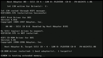

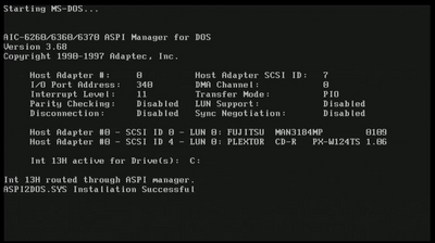

This is actually the best reference on the built-in chipsets.
https://mastodonpc.tripod.com/personal/4253.html
Reply 3 of 17, by Disruptor
Seems like you need ASPI2DOS.SYS
mkarcher and me never have checked controllers like the AHA151x or AHA152x for large disks - like he did with 274x and 284x and ASPI7DOS.SYS
Reply 4 of 17, by un1xl0ser
Disruptor wrote on 2023-07-04, 22:17:
I am booting off of the drive, so with ASPI2DOS.SYS and the appropriate DISK.SYS it says that the disk is under BIOS control. At least that is on DOS 6.22. I haven't dried putting a secondary SCSI drive on there to see, mostly because there isn't space inside the case for it. If I am feeling froggy I will get a SCSI2SD set-up to see if disks loaded after that have < 1GB workable. That may able to be in there, and can at least get it working.

The provenance of the drivers is Adaptec EZ SCSI 5.0c for DOS / Windows 3.1. ASPI2DOS.SYS is version 3.86 from the attached screen-shots.

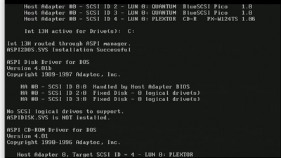

I created 2 x 4GB drives with BlueSCSI, made them targets 1 and 2. They are recognized fine. They have been low-level formatted with SCSIFMT and passed validation to the full 4GB.
It says no logical drives though, and the DOS 6.22 FDISK seems lame, or I am missing switches. Will be spending more time to RTFM, but if anyone has any pointers, it would be appreciated.
