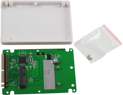

If you want the fastest speeds for a PATA device for a reasonable price, consider:
1) get a 32GB Msata device on ebay for $10-20
2) place it a $5-10 44pin pata sled like this:
67.9 KiB
1119 views
Note: make sure you get an M2 sled if you have an M2 msata device or an NGFF sled if you get an NGFF device.
3) and then get a 40-44 pin IDE pata adapter for $5-10
I put together a couple of these and they easily push data at rates over 70MB/s when running at UDMA-6. They also supports trim commands, if that's something you want to use.
