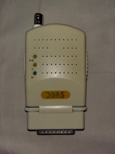

I have this piece of HW. But I need working NDIS and/or packet driver. Drivers from internet don't work, except one ODI driver for Win95. Also FD100II drivers don't work (RTL8012 chip instead RTL8002)

http://web.archive.org/web/20030422075211/htt … PORT/driver.htm
unfortunately fd100 is one driver that won't DL, prior to Dec 2002 all files were ftp which is dead...
Reply 2 of 6, by Starej_Mraf
This file can't be found on whole internet. I hope that someone have it in private archive or have this adapter with floppy disk. 😀

Hi there everyone!
I've got a few of these adapters and have had uploaded their drivers a few years ago.
Not sure about their chipsets, though. 🙁

This archive shows that last versions of RTL 8002 drivers: http://web.archive.org/web/20000407130300/htt … 8002-driver.htm
ALL8002.EXE can be found and appears to have a RTL8002 NDIS2.0 Driver (v3.2) in the REDPNDIS.320 folder, (there are 2 diff .DOS files, would have to try both) if it does not work then not sure where else to look....
added: inside the 8002VERF.100 folder is a "TEST" folder with a POCTRB.COM and TRB.BAT files which appears to be a DOS level diagnostic for checking the para port adapter.....
Reply 6 of 6, by Starej_Mraf
I already tried that package, but only ODI driver from SVEC.95 directory works. (in Win95 and Win98). The other drivers shows on startup bad MAC adress. So it is problem of genereic RTL8002 drivers and SVEC has some way modified driver.
