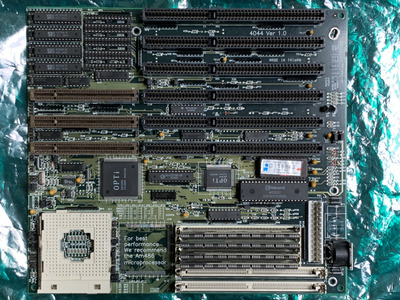

My DataExpert EXP4044VL Motherboard
I have an DataExpert EXP4044VL motherboard (https://theretroweb.com/motherboards/s/dataexpert-exp4044) with revision 2.1 of the BIOS (attached, and I'm also the person that submitted that version of the BIOS to The Retro Web). This board has a silkscreened note recommending Am486 processors, and it will happily boot with my AMD 486 DX4-120.
However, this board will not POST with my Intel DX4 100MHz processor in an Aries adapter board (the same adapter I used for the AMD DX4 processor), and it will hang during the memory check when using an Intel Overdrive DX4 processor, only to crash before booting.
Think I'm crazy? Here is a link to my livestream to the timestamp where I tried these two processors again, after carefully checking the motherboard jumpers, just to confirm my previous results: https://www.youtube.com/live/5coxaVeSVpA?feat … re=share&t=3313
This has me wondering if the BIOS for this board might be locking out the Intel DX4 processors, but I don't know how to uncompress an Award BIOS and don't know 32-bit assembly to determine this for myself. So I'm wondering if any of you might be able to tell if this is an active lockout in the BIOS...

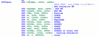

This BIOS is not compressed and I don't see any code to intentionally lock out Intel DX4s and I don't think that would make sense as it would probably cost extra money to get Award to produce such a BIOS. Further, it runs in PCem using either CPU, but I'm not sure how thoroughly PCem distinguishes these in its behavior. But I do think there is a problem in the CPU detection table at 7354h. The first field is a set of flags I haven't investigated further, the second is the minimum DX-at-reset value for that class of processor, and the third is the maximum.
12 KiB
294 views
Notice for the DX4 WB the stepping is hardcoded as zero (490h-490h) rather than being ignored as it should be (490h-49fh). I think this means the Am486DX4 is not considered a DX4 WB, while your i486DX4 &EW is detected as one, and the misdetection cancels out whatever WT/WB issue is going on with your board.
It is also weird that this board apparently supports DX4 WB, or at least the BIOS attempts to detect one, but doesn't support the P24D aka DX2-WB with DX=x47xh. Usually it is the other way around.
It's also possible that the board shipped from the factory wired wrong to support 486 WB CPUs. You can read a bit more about that here. Note your Enhanced Am486DX4-100 would exhibit the same L1 WB issues as the Am5x86: http://web.archive.org/web/20220407063508/htt … ink/amd5x86.htm

What I found was a regular code base for an Award 09/1994 BIOS with CPU support for all 486 models of that era. This includes support for the iDX4-100.
However, L1 cache WB mode in this BIOS is only supported for the Intel 486DX2-WB (P24D) and for Cyrix design 486DX/DX2 models. So the Intel 486DX4 &EW and Enhanced Am486DX2/DX4/Am5x86 are only supported when set to L1 cache WT mode.
I believe the 486DX4ODP comes in WT versions only and should run without issue with this BIOS.
Seeing your video, I think there must be something else wrong with this board.
About the curious “For best performance we recommend the Am486 microprocessor” indication on this motherboard, I think this has something to do with this being a VLB board.
Because the VLB is coupled to the FSB of the CPU, running the VLB and FSB at 40MHz gives a better performance than 33MHz when using VLB cards instead of ISA.
After the i486DX-40, Intel stayed with 33MHz FSB on their 486DX2-66 and DX4-100. But AMD went further with their Am486DX-80 and Am486DX4-120, running on a 40MHz FSB!
Or DataExpert had a commercial interest in AMD? Just speculating. 😉
Anyway, I find it hard to believe that this silkscreened Am486 recommendation means that the board has trouble running CPUs from the leading manufacturer…
@jakethompson1, over the years I did some detailed analysis on 1994 and 1995 Award socket 3 BIOSes and I agree with your view on the CPU Reset_ID table in this Rev. 2.1 BIOS.
Only the third table item, 0490h-0490h, is for the Cx486DX and not the DX4-WB. 😉
If you like to read what I discovered about the CPU type detection in these Award BIOSes, check-out my DIY BIOS Modding guide at: Re: Diy modding support for k6+And 120gb hard drives into bios roms
It is true that the Reset_ID table doesn’t contain a dedicated 047xh item for the P24D. But this BIOS has a separate routine with hardcoded CPUID ‘GenuineIntel’ instructions to detect this i486DX2-WB. It is the only place in this BIOS where CPUID is used.
In addition, separate code is used to detect Cyrix design CPUs (DIV 5/2 method).
Cheers, Jan
