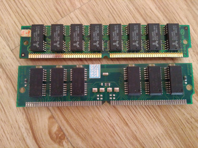

I recently bought a pair of 72-pin SIMM EDO rams, they won't fit in my memory slots however. My mainboard is Cyrix 586 GX Lite. I have thought that EDO rams have the exactly same size.
My original memory stick.

The new bought Alliance memory stick.

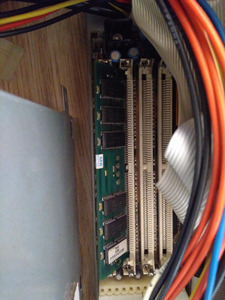

I tried to force the Alliance ones into the slots, but my motherboard won't recognize them(Repeated beeps at boot up). What could be the problem?

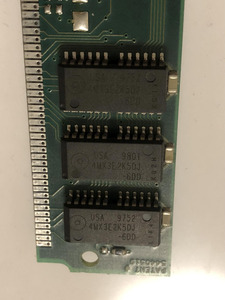

Reply 3 of 7, by dionb
The photograph doesn't show the chip inscriptions on the second SIMM well enough to determine its specs (even whether it's EDO or FP or something else entirely), and it looks pretty unusual. It's not impossible it is a regular 32b SIMM, but I'd want better pictures to be sure.
The first one is a pretty regular 72p 32b SIMM with 4Mb EDO chips, so if it only has chips on one side it is a 4MB non-parity module and if it has chips on both sides, it's 8MB non-parity.
But isn't this a simpler issue? The MediaGX has a 64b memory bus, so needs SIMMs installed in pairs - electrically identical pairs. If the second SIMM isn't identical to the first, it won't work. Given the six visible chips on the SIMM, I strongly doubt it will be electrically identical to the first one. In which case no POST - which is what you are seeing.
Here is the clear version:

Sorry for not making sense. I should've said I have two of them each, the picture posted earlier is intended to show the difference. They are all 2-sided 72pin 16mb EDO rams. I don't know the exact model number of my original ram, but they work.
When inserted in pairs, the BIOS recognizes them as 32mb in total.
The Alliance won't be recognized by the machine, when inserted(forcefully) in pairs there are repeated beeps, no video.
The interesting part is when I pair these two different rams, the BIOS recognizes only my original one. The total amount of ram is 16mb. Then throw a "memory test failed" error.

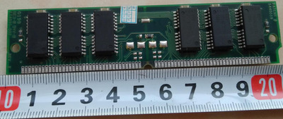

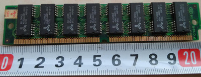

They have almost the same size with only about 0.2mm difference. Note the round opening in middle of the connecting fingers.

GunKneeNeon wrote on 2023-07-11, 11:44:
I strongly doubt that. 16MB SIMMs have an odd power of 2 chips onboard, so 2 64Mb chips or 8 16Mb chips.
Even with a good pic I can't figure out what chips those things with "4MX3E2K5DJ-6DD" are - "4M" or "4MX" isn't any regular vendor code.
But the Alliance chips are clear enough and they are 4Mb chips, not 16Mb, so those 8 chips visible in the pic amount to 4MB. If there are 8 more of the same type on the back, that's an 8MB SIMM, not a 16MB SIMM.
Not convinced that difference is real - it looks like the second SIMM is shifted to the left in its entirety (see left edge) rather than any difference in the key slot.

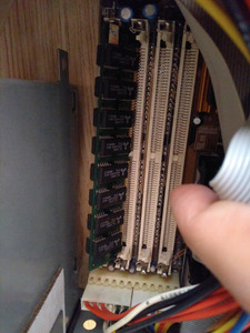

Oops, my measurement is faulty, but see the picture with the memory slot. The Alliance one won't fit the slot, I have to force it in. I have other two different pairs of rams, they all fit naturally just like my unknown 16MB EDO ones.

Reply 7 of 7, by rasz_pl
Line up two SIMMs facing each other with pins edges touching. From the pictures with ruler it looks like hole is one pin off
