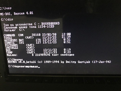

Reply 207 of 343, by Errand
n0p wrote on 2023-11-15, 08:11:
I don't see what could go wrong there - CGA BIOS contains only charset and no code
https://github.com/jinshin/Book8088/blob/main/cga866v2.bin
No idea if it would work, but i think it should
It worked! 😀
55.8 KiB
1496 views
Volkov Commander settings shows all symbols from cyrillic code page. OS text is now visible/readable.
UPD: Problem with typing is resolved by using 'cyrillic.com' or 'kbdrgost.com' layout switchers (first one has more comfortable key combination).

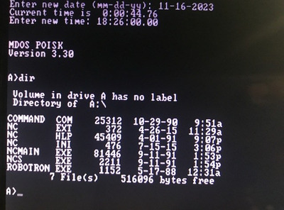

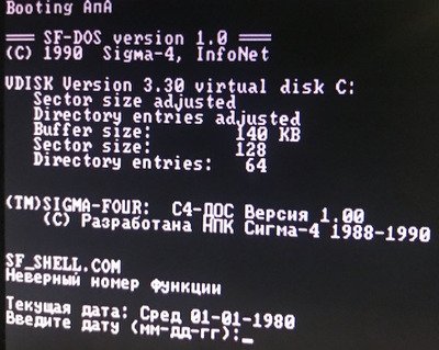

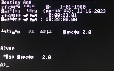

Reply 209 of 343, by Errand
Jo22 wrote on 2023-11-13, 00:37:
^For authenticity, there's the DOS for the Poisk-1, SF-DOS ('Sigma Four').. Poisk was a series of eastern PC compatibles. That […]
That DOS should be on MS-DOS 2.11 or 3.x level.
Alternatively, there's the East German DCP in version 3.20/3.30.
The Disc Control Program uses latin characters/filenames, at least.
So if you got the German language version, you're not totally screwed.
That being said, learning cyrilic alphabet isn't that hard, either.
It's worth a try, if free time permits it.
PS: For really, really old school fun, AlphaDOS might be an option. It's non-English, though.
See https://pikabu.ru/story/pp_yevm_es_1841_6484535
Edit: https://en.wikipedia.org/wiki/ES_PEVM
Edit: Picture attached.
I've tested booting few more versions of OS on v2 (sorry for the low quality of photos):
1.Most unsuccessful was sf-dos: once booted, it asks for the date and then hangs up (Ctrl+Alt+Del isn't working).
72.11 KiB
1351 views
2. MDOS Poisk played the best for me: it boots normally, everything went well. Haven't tried running enything except NC, will play more with it.
63.61 KiB
1351 views
55.37 KiB
1351 views
3. Janus have failed to render cyrillic symbols.
Gotta try hard booting with mode 80 properly set due to the Book8088's screen, that is eating the first column of the text on the screen - otherwise it will show something else instead of "JANUS" 😀)))
43.93 KiB
1351 views
I'd like to have SF-DOS working - it reminds me the time when I was working on Poisk in school...
Looks like SF-DOS is handling cyrillic symbols more correctly, than Janus.
UPD: I was able to run SF-DOS shell from MS-DOS, booted within system disk C.
It doesn't work when booted from floppy: on one of forums the guy wrote that the floppy image doesn't contain track 81 data, which the system appear to try reading.
Need more experimenting with different SF-DOS floppy images - they're not that easy to find.

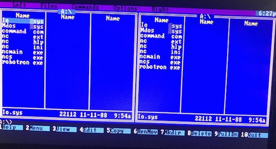

Reply 210 of 343, by Jo22
Thank you very much for the photos/screenshots!
It's great to see Norton Commander running so well! 😃
Errand wrote on 2023-11-16, 17:09:
I'd like to have SF-DOS working - it reminds me the time when I was working on Poisk in school... Looks like SF-DOS is handling […]
Hi again, sorry to hear there's some trouble..
- I'll keep looking for boot-up disks, too. 🙂
PS: Maybe it's unrelated, but I recall earlier operating systems to have trouble if the floppy controller is acting weird (or simply absent).
If I remember correctly, early versions of PC-MOS/386 did hang if no floppy drive or floppy controller was installed.
The developers didn't thought of this scenario when writing the OS.
