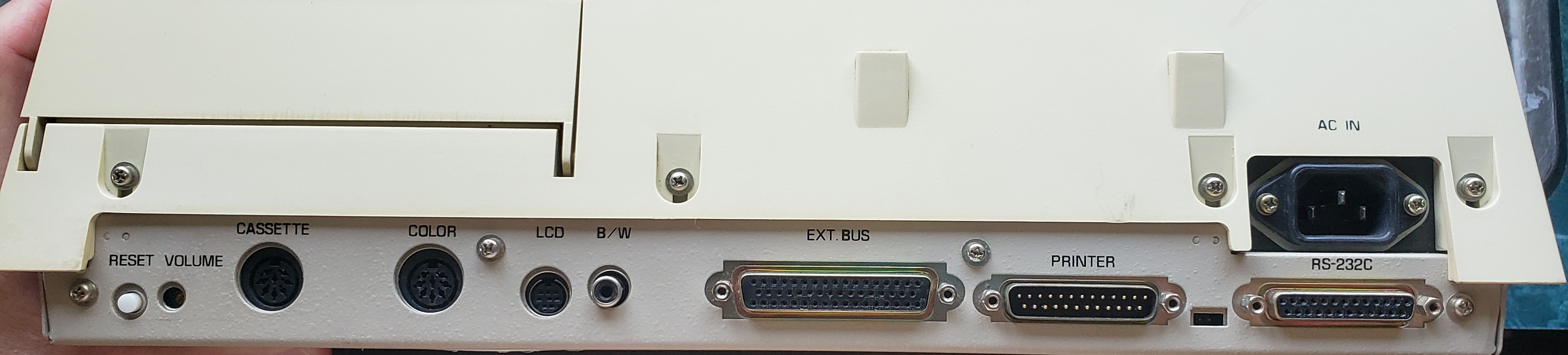

I've been scouring the internet since I ended up with a Toshiba T-100. It's a pretty nice little machine, really, but there's not a lot of usable information online about it. Maybe it didn't sell well here in the USA?
Anyway, I'm looking for information - programming manuals (especially T-BASIC 1.1), owners manuals, anything really about the T-100. I've found some info on the Pasopia, but translating computer commands and uses isn't working out well.
I only have the base unit, no dual disk drive box, or any cables. I'm using the B&W RCA composite out for now, which is fine. I've found some pinouts as well - for the Pasopia - which has different connectors on the back.
I'm using an emulator to try and get the hang of things, but I can't seem to get the disk drive options to work correctly. Seems that OA-BASIC has a 'disk' version and so does T-BASIC.
Somehow the emulator doesn't see the drive as connected, and it's the same on the actual machine as far as errors go. Maybe there's a hardware connection when the drives are plugged in to show that they're present.

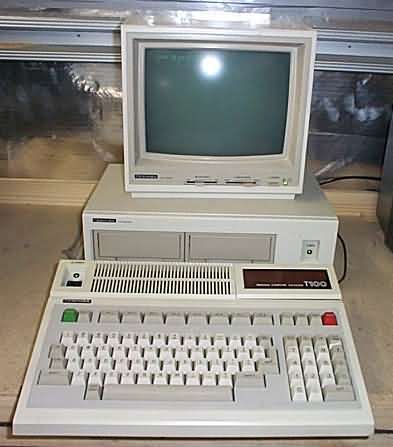

I'm also including the best picture I could find of a complete setup. I'm not particularly worried about the monitor, but the drive box would be nice!

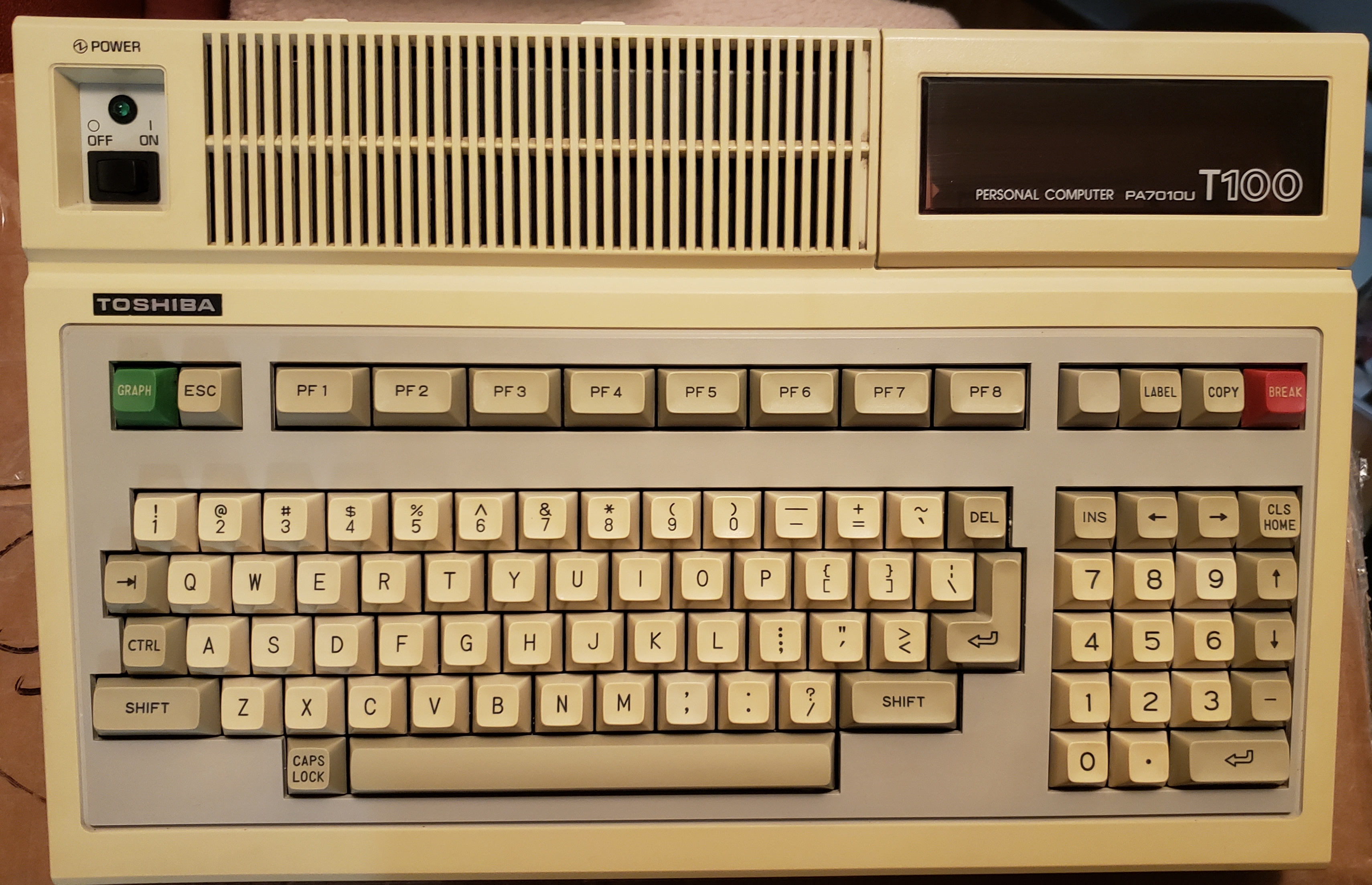

Toshiba T100
http://www.eanubis.net/ToshibaT100.jpg
Toshiba T100 back panel
http://www.eanubis.net/ToshibaT100BackPanel.jpg

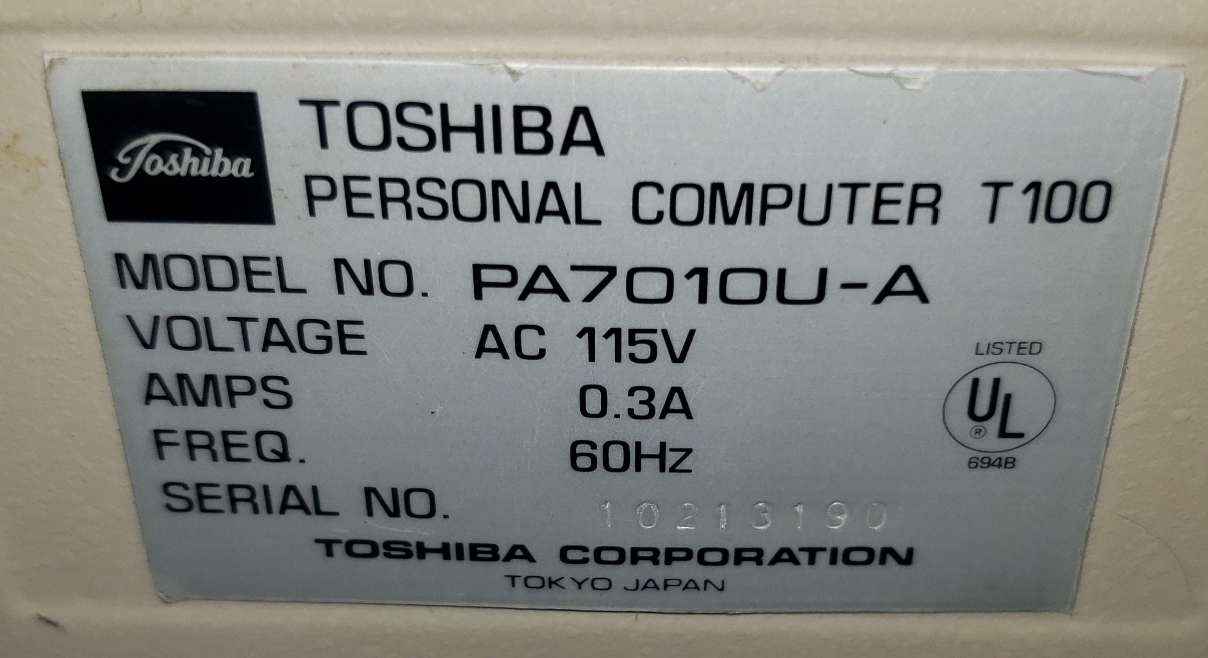

Toshiba T100 model sticker
http://www.eanubis.net/ToshibaT100Model.jpg
Toshiba T100 complete setup (best I could find online)
http://www.eanubis.net/ToshibaT100Complete.jpg
