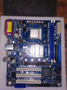

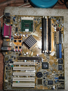

Reply 15 of 52, by Hoping
My opinion, without being an electronic engineer or anything similar and having a great lack of technical knowledge about electronics, is that there may be more than a hundred threads on capacitors in this forum and more or less the same thing as in this thread are always repeated.
Personally, I don't like spending a lot of money on old hardware, so I always use polymer capacitors that I get from motherboards that I can't repair.
My rule is half the capacitance and I check the voltage that the capacitor has to withstand in that place, for example the VRM capacitors of the processor, if they are Socket 462/370/478 or newer, do not exceed 2V unless you do a high CPU overvolting, so I use 2.5V capacitors, and sometimes I add an MLCC on the opposite side in parallel, in the case of boards that do not have the 12V auxiliary connector, almost everywhere the 6v capacitors or 6.3v are valid.
This post from PCBONEZ clarified many things for me, and he explained it a lot better than I can do it. Re: Capacitors of Asus TUV4x and Gigabyte GA-7VT600 1394
I put some example images.
In the case of the A7N8X-X the three 470uf and 16V capacitors get quite hot, possibly because at 5v they have to withstand a fairly high current and the capacitance is very low, the originals were 1200uf I think I remember, maybe more, but it is designed for a future mod and use an auxiliary 12v connector so I imagine that the current they have to withstand will be less.
The other two motherboards do not present any temperature or stability problems, in fact, the temperatures are lower than with electrolytic capacitors.
I repeat that I am not an electronic engineer and I lack a lot of knowledge and surely there will be those who say that it is crazy and that one day I will cause a fire but in years it has not happened yet.
Nobody pay attention to me, I am not responsible for anything.

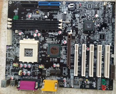

Reply 17 of 52, by Hoping
mockingbird wrote on 2023-10-18, 00:31:
Hey, how is that Aopen AK73? Do you like it? I have one and I was thinking about re-capping it. Anything special about it?
It is an AK73(A) that is, KT133A+686B. With the latest version of BIOS it does not start with the Athlon XP, which forces you to get one of the few T-Birds that exist with a 266 bus if you want to take advantage of it. I tried an XP 1500+ and it does not start with the bus at 133 but with the bus at 100 it does, but it does not recognize it as Athlon XP. I have a Soltek SL-75KAV that does recognize the Athlon XP and uses the same chipset. I did this today because I didn't remember anything about this motherboard to respond. The truth is I don't find anything special apart from the option to enable Sound Blaster emulation in the bios for MSDOS, for me this is not very useful but for someone it could be.
I did the tests with a T-bird 1000Mhz, with the 100Mhz bus I don't find any problems, but with the 133Mhz bus (1333Mhz) it does strange things, it seems stable for a random time, it doesn't fail in memtest.....etc, but suddenly it fails in some weird way. It does not have CPU voltage control.
I found it curious to do the poly-mod because the motherboard is black and using those capacitors makes it look much newer or something like many modern retro motherboards but without being truly modern.

Reply 19 of 52, by shevalier
Hoping wrote on 2023-10-17, 14:15:
Well I see some mistakes. On yellow boards, capacitors with blue markings do not look good - only with red and black ones.
On blue ones - everything except with green markings.
And everything is fine. 😀
Because everything else is "urban legends" about the instability of the voltage regulator.
