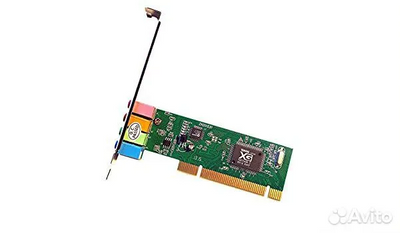

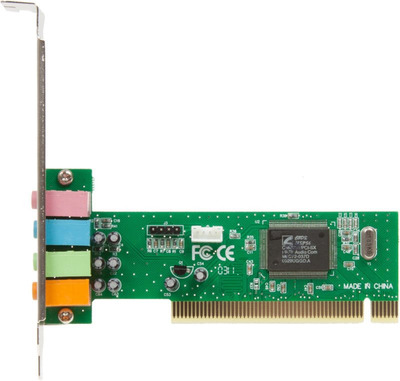

Nah, they just print YMF744 on a C-Media chip. No actual chip cloning takes place. Apparently they have a universal PCB that they solder new old stock chips to, and sometimes the chips are labelled as something they are not.

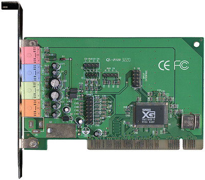

Right. That's what I heard as well. Here are some pics I've found to illustrate
C-Media card. No codec chip

Fake Yamaha. No codec chip

Actual Yamaha card, very similar to yours, with a standalone codec

I found a bunch of the latter card for sale somewhere in Russia for usd 5 each. So yeah, not a rarity for sure.

Well, if it turns out to be a good MSDOS card, I won't care if it's rare or not 😀)
