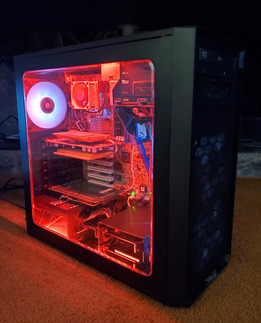

I have a Define R5, but don't really like it. It's too bulky for my taste and I'm not a fan of cases with doors.
I prefer the Fractal Design Focus G cases (I have 4 of them) for any retro-builds in a more modern case. More slim compared to the R5, have dual 5.25" bays, plenty of airflow, and are available in a handful of different colors.
