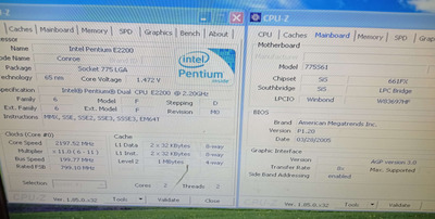

Reply 21 of 55, by Vlad94
k24a1 wrote on 2024-02-05, 18:02:
I am curious about how you make the specific pin mods. Is there a schematic you use as a reference? I'm sure it would be different for all types of motherboards.
It wouldn't, that pinmod just makes VRD11 (core 2) CPUs runs on older VRD10.1 (pentium 4/d).
VID mod is optional, but recommended! Voltage tables are totally different in VRD10.1 vs VRD11, i mean, you never can expect what voltage CPU will get, for example:
E5800 got 1.48v
X6800 got 1.56v
E2200 got 1.5v
E4700 got 1.58v
E7600 got 1.42v
All with no VID mod.
210.74 KiB
502 views

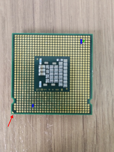

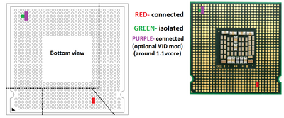

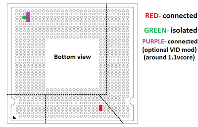

Reply 28 of 55, by tiagotarifa
Vlad94 wrote on 2024-02-05, 22:39:
I have a core 2 duo E4300 and IBM Thinkcentre M51 8141 with i915G chipset. I want to give a try in this mod but I'm a little bit confused.
In you picture standard.png the pinouts are mirrored of a cpu bottom. So, this mod will be like this on my CPU:
649.37 KiB
524 views
Am I right?

Reply 30 of 55, by Vlad94
tiagotarifa wrote on 2024-02-09, 11:03:
You are confused because I did STUPID mistake, thanks for noticing! I fixed it in all posts.
It should look like this:
779.49 KiB
501 views

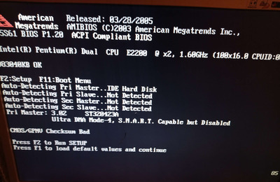

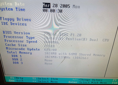

k24a1 wrote on 2024-02-12, 18:11:
I should give the pinmod a go on one of my zd8000 boards and see if it'll work. I doubt it will initialize but it wouldn't hurt to try since I've got a unit with a faulty GPU... if it works it'll be one heck of an upgrade for it, but obviously the BIOS will be a pain in the ass for obvious reasons (Phoenix cME). There's also an unused SATA port that I'd like to get working but I'm not too sure how.
Non-core 2 Award and Phoenix never worked with Core 2 for me, only AMI.
Even super old version of AMIBIOS from Asrock 775S61 works with Core 2. (I would call it socket 478 board with socket 775 soldered 🤣 ,it have gameport, but no SATA 😳)
Wolfdale freezes in BIOS after like 20 seconds, but Conroe works fine. Sadly I don't know how to add microcodes to such old AMIBIOS 🙁
