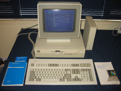

PS/2 were my first PCs. My father was leading facultative courses of computer science in a school back in early 90's, and sometimes he took me with him. I were playing Prince of Persia and Golden Axe while he was teaching elder scholars of how to use Microsoft QBasic.
I can't say for sure what those PS/2 were. However, some details I still remember:
- they were 286-based
- had 640K of memory
- no HDDs, only 3,5" drives (720K if I'm not mistaken)
- if no boot diskette is inserted, some primitive BASIC was loaded from ROM. GWBASIC or BASICA maybe.
- I think there were EGA displays (non-integrated)
- no sound other than PC Speaker
What model could those machines belong to?

Those had to be the PS/2 model 30s if it was dual 720k drives. But they were only 8 or 10mhz 8086, not 286 processors. I still remember that built-in GWBASIC. Pretty annoying if a disk went bad.

AFAIR there was only one 3.5" drive. Looked pretty much like this: […]
Ahh, then this is the 30-286. 😀 Looks identical to mine. The model 30 had an orange power switch. At first I hated such a solid power switch, but thinking back, I'd rather have that than the 'I'm smarter than you are and I'll tell you when I'll disconnect power' power switches of today.
