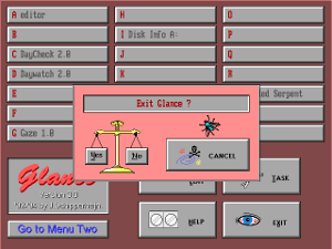

Reply 17 of 22, by ik777
This one is unused for you, but all PCs before windows 95 in my country used this one.
    63.49 KiB
    3352 views
