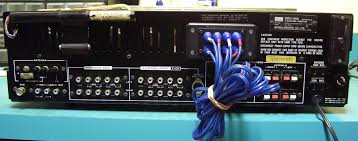

My Sansui is back! 😀
Yes, after went out of service in late 2013, it is finally restored. Now it drives my NHT SuperZeros, and I'm in audiophile nirvana.
The venerable Sansui AU-7900, still great-sounding as usual.
Kreshna Aryaguna Nurzaman.
