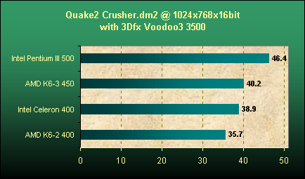

I've been doing some tests with other cards, seems like this motherboard just doesn't like 3dfx for whatever reason, be it Voodoo 3 or Voodoo 2 SLI.
I'd have to disagree with you on this one swaaye, some of these scores are downright pathetic. I've been checking reviews from Anandtech and Tom's Hardware from 1999 and 2000 and I'm quite off. Especially on Shogo, Quake 2 Crusher and Turok 2.

Reply 44 of 96, by swaaye
Yeah nevermind me. I was overestimating the slowness of K6.
http://www.tomshardware.com/reviews/cpus-amd- … tel,101-14.html

Reply 46 of 96, by F2bnp
Yep... I tried with and without them. I'll see what happens after I've installed a fan on my GF2MX. I noticed a lot of artifacts in NFS II SE with the Voodoo 2 cards and eventually crash to desktop. I let the machine cool off a bit and tried again and it didn't happen until 3-4 minutes in.
I can confirm though that the Voodoo 2 cards again give me about 21fps in Crusher.dm2 in Quake 2. I was just having a chat with my friend Markk and we laughed it off because this is just something I do on my spare time. But imagine if it was actually 2000 and I was building a machine with these specs. It would have driven me insane, that's for sure xD
