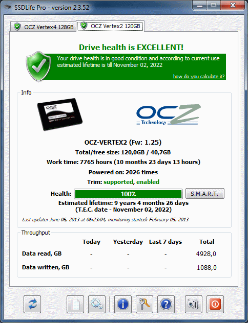

Joey_sw wrote:
is there any tools to report how many minimum write cyles are remaining?
its nice to know when the SSD will be dead, so you can prepares another one in timely fashion.
There is this, whatever its real worth.
