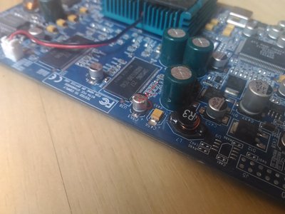

I have a question about solid capacitors.
I'm replacing a couple of caps on this Radeon 8500 LE (it got quite a beating as the guy who sold it had it just rattling about in a box with a bunch of other cards) and one of them seems to have an inward dent in them:
963.97 KiB
577 views
Are these types of caps still able to work or should I replace it? If so, I assume its 47uF 6V? What does the 17 stand for?
