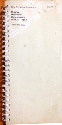

The Display Hardware Maintenance Manual for PS/2 displays arrived today.
It covers servicing information including a complete parts list for PS/2 display models : 8511, 8513, 8515 (mine), 8516, 8517, 8517, 8518, 9515, 9517, and 9518.

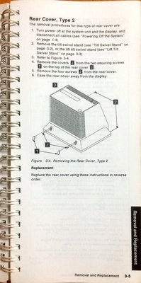

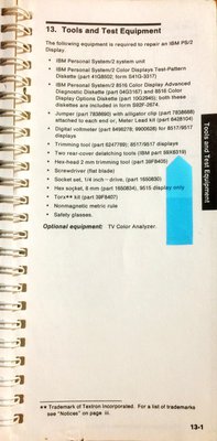

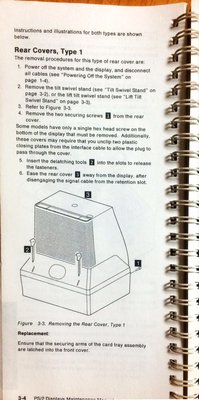

Regarding how to remove the rear covers it shows that this is done with two little delatching tools (part 59X6319). These are listed also listed in the Tools and Test equipment section required to repair PS/2 displays (see list also in picture below)
If any one is interested in the diagrams of any of the monitors listed above let me know and I will add them add the pictures as part of this post.
    202.89 KiB
    2431 views
    Front Page
    306.97 KiB
    2431 views
    Type 1 Rear Cover - Delatching tools
    254.2 KiB
    2431 views
    Part number of Delatching Tools
    256.03 KiB
    2431 views
    Type 2 Rear Cover - Security Screws
