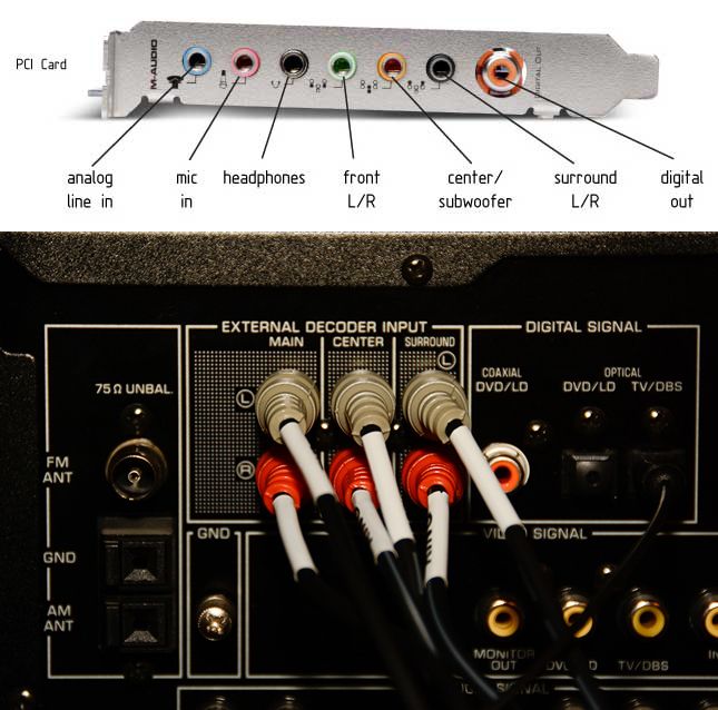

5.1 sound cards. Many EAX sound cards I know is 5.1 sound card. That is, it has multichannel (5.1) analog outputs designed to use with 5.1 multimedia speakers. Unlike surround sound upmixing technology like like Dolby ProLogic or DTS Neo, a typical 5.1 sound card can generate discrete surround sound, similar to those movies that mastered with Dolby Digital instead of Dolby ProLogic. Unlike Dolby Digital movies, though, a game's discrete surround sound is dynamically mixed in real time, with technologies like DirectSound 3D or Aureal 3D. So the sound you hear is based by your action in the game.
Let's supposed you're playing an FPS whose surround sound is generated dynamically using DirectSound 3D. A bomb is about to explode in front of you. If you keep facing the bomb, the explosion would be heard from the front speakers. If you turn around to put the bomb behind you, the explosion would be heard from the surround speakers. In order to heard such dynamically-generated surround sound behind you, you'd typically need to connect the sound card's multichannel analog outputs to the AV receiver's multichannel analog input. On a typical receiver, the multichannel analog inputs are usually labeled 'EXT IN' or 'MULTI CH INPUT' or 'EXTERNAL DECODER INPUT'. Here, the AV receiver typically doesn't do any processing. Instead, it'll act as multi-channel power amplifier with master volume knob for all channel.
A 5.1 sound card's multichannel analog output (above) and an AV receiver's multichannel analog input (below).

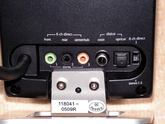

Those who use multimedia surround speakers like Logitech Z-5500 should be familiar with this setup, since such multimedia speakers typically has multichannel analog inputs, usually labeled '6CH DIRECT' or such. The difference is a multimedia speaker usually uses 3.5mm headphone jacks for its multichannel analog input, while an AV receiver uses RCA.
Multichannel analog inputs on typical multimedia surround speakers.

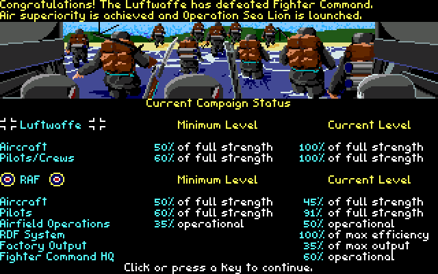

Their Finest Hour: Mono Movie. Not for the game itself, since it only has PC speaker sound, but for the Glenn Miller big band music I usually play in the background when playing the game.
Are you sure? I remember it having AdLib sound? Anyway, it did sound terrible compared to the Amiga version, though it was almost unplayably slow back then.
Yep, quite sure. I finished Their Finest Hour in 2015, and I didn't remember the game using Adlib at all.
