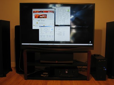

I guess you could say I have three XP gaming machines. One of them doesn't even run XP, but I have a ton of XP games on there. Jeez, it runs them better than the actual XP computers!
Number 1 is kind of an early XP machine that also happens to run many newer Win98 games completely maxed out. This machine copes surprisingly well with games up to around 2004-2005. A couple of months ago I finished Prey, a 2006 game, on it. This machine can even run Crysis at 21 fps @ 800x600/low!
-PIII-S overclocked, 1575MHz
-2GB of CL2 DDR at 300MHz to match the FSB
-evga 6800GT AGP
-X-Fi XtremeMusic sound card. EAX 5 in a PIII!
-500GB 7200RPM IDE/PATA hdd
-QDI Advance12T motherboard
-An old LG Blu-ray drive that came from my main rig when I upgraded to a BDXL writer. Hooked up to PCI SATA card
-An older Zalman 400w PSU with an astounding 40a on the 5v rail mounted in a newish Antec case.
-XP Pro SP3
254 KiB
1357 views

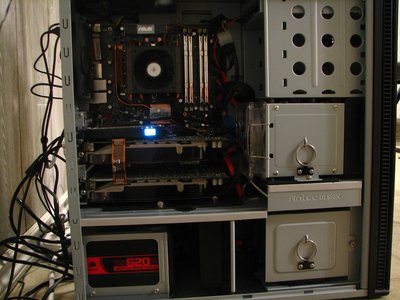

The second machine was built in 2006. I used it as my main machine until 2014. Even today it could still be used comfortably as a web surfing box. There's enough CPU power to handle 1080p HTML5/VP9 youtube video with ease. This machine has two hard drives and dual boots XP and Win7.
-Socket 939 dual-core Opteron 185 overclocked, 3GHz. I won the silicon lottery with this chip. It runs completely stable at 3GHz on stock voltage (1.35v)! With a little more voltage, it'll do 3.13GHz, but at that point it's really hitting the limit of the stock AMD heat pipe cooler. So, I just run it at 3GHz.
-Two overclocked (via firmware) G80 GeForce 8800GTS 640MB graphics cards running in SLI mode. Through NVFlash, I ratcheted these babies up to 625/1458/1950 (up from 500/1200/1600). By some minor miracle, these cards still work just fine and show no signs of quitting!
-The best socket 939 motherboard: the Asus A8N32-SLI Deluxe. 40 lanes of PCIe for true x16/x16 SLI. Passive heatpipe snaking through the board to keep the Northbridge, VRM, and NV SP100 chip cool.
-Creative X-Fi Titanium Fatal1ty Pro sitting in the PCIe x4 slot.
-4GB of CL2 PC3200
-Two 1TB/7200RPM SATA hard drives. One for XP SP3; the other for Win7 x64
-Corsair HX620 PSU in an Antex P182 case
263.11 KiB
1357 views

Reply 13 of 55, by Standard Def Steve
KT7AGuy wrote:
Standard Def Steve: Your Tualatin system is amazing! I'm a bit surprised to see it only getting 13655 in 3DMark2001SE. Something doesn't seem right. I would have thought it would get closer to 18000. Maybe I'm confused.
Thanks!
18K is firmly in 2.8/800FSB P4 territory. However 13655 is roughly what a 2.4/400FSB P4 or Athlon XP 2400+ gets with a 6800GT, which I suppose is fairly good for a PIII system. 😀
