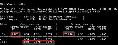

Here are the values that get added to the database:

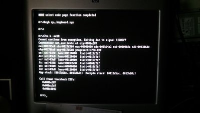

Tried DOS version in some PCs, i tried on my HP DC7800 which i used to write the floppy and my AMD K6-2 build, also tried on my 486-SX 25, but it crashed, i guess 7 Zip needs FPU acording to the errors
    1.12 MiB
    5637 views
    error on the 486-SX
