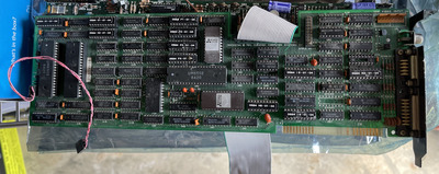

I just received a Trackstar in a lot of ISA cards that I picked up from a recycler.
What’s interesting is that my card doesn’t look like any of the images posted online, though I suspect that it’s an original 64k model:
1.56 MiB
1227 views
Has anyone seen a card like it? Based on a comment on your site @DeathAdderSF I think that this is the version that supports CP/M, as you can see that there is a Z80 onboard, partially obscured by the speaker extension cable.
Thanks!
- Alex
