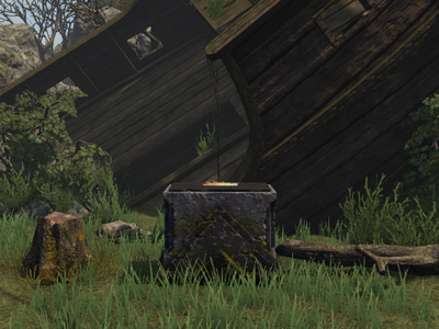

So I wanted to know if 1080p could be displayed similarly to 1080p displays on a 4K display and I decided to try the simple thing:
1.81 MiB
549 views
And it works pretty great: almost no perceived aliasing or blurring. Looks almost exactly like my 1080p monitor.
Unfortunately it has two pretty severe problems. Like console scanlines there's a pretty high brightness cost and there's no way to practically use it for games.
Still would be more generally useful than the integer scaling everyone is begging AMD and Nvidia to implement. I wonder if most of them realize what they're asking for.

Do you really prefer the nearest scale Legend of Grimrock 2 screenshot I posted to the lanczos one? Or the "scanline" one?
I run some games in 1080p on a 1440p display, and I use ReShade's "Luma Sharpen" shader. To the naked eye, I can't tell much if any difference between native 1080p and upscaled 1440p, unless I look at the image so close that my nose is touching the display.
A value of about 0.6 gives me the best results. The value you need might be different when upscaling to 4K though. It also depends on whether you're using GPU scaling or display scaling (some displays already apply some sharpening when upscaling, or use an upscaling method that is less blurry than the bilinear filter used by GPU scaling, so a lower Luma Sharpen value might be better.)
Some games have a built-in sharpening shader, in which case you could use than instead of ReShade.
Anyway, long story short: post-process sharpening works really well for running games at lower than native resolution!
