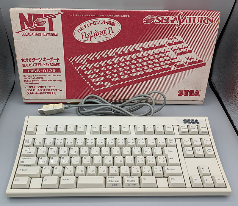

Overall, the keyboard is comfortable and well made. There are games that I actually like to play on a keyboard more than on a wireless gamepad or Sega 3D gamepad, so I recommend this keyboard for purchase despite some shortcomings.

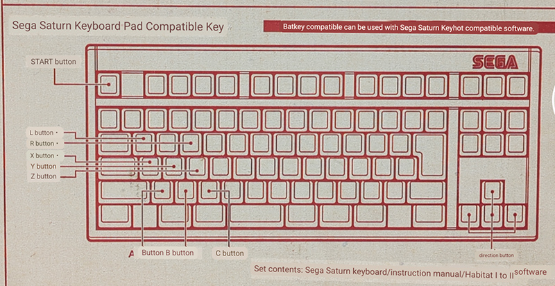

At the same time, the keys for games cannot be reassigned, the maximum possibility is to change the layout options, just like for a gamepads by swapping the action keys. The selected keys are hardcoded and are shown on the back of the box (fortunately, at least the arrows are involved, but the spacebar is small and not used). ESC key replaces the Start button, but this does not work in all games. In addition, some games may complain about an incompatible peripheral device and pause if the gamepad is replaced with a keyboard.

Got to appreciate this kind of contributions, definitely no small feat to go through with extensive testing like this. Wonderful example of a unit, and with the box no less.
