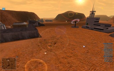

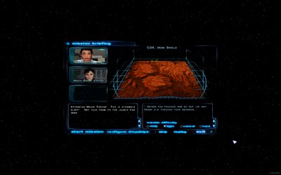

Ground Control doesn't look so hot when I use NVIDIA DSR to get 16:10 4K resolution - the downscaling makes all the text and buttons nearly-illegible. Thankfully, dgVoodoo2' 2.52s resolution forcing to the rescue! FYI, I used the Ground Control Resolution Changer to hex-edit gc.exe with a resolution of 1024x640.
