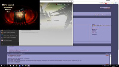

Reply 2622 of 3949, by KainXVIII
stranno wrote:
Digital Foundry recommending dgVoodoo for MDK 😀
https://www.youtube.com/watch?v=_LbIJdGNQfA
I don't get it how to achieve fullscreen image with dgvoodoo in MDK (gog version), il always stays windowed in top left corner of the screen...
UPD - ok, so i somehow solve this problem, but there is another - how to get rid of blinking lines around edges of screen?

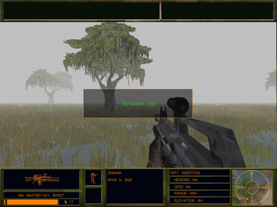

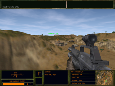

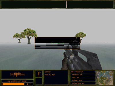

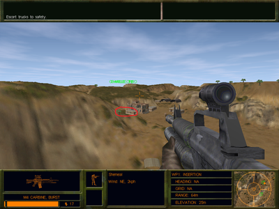

Reply 2623 of 3949, by ed_barber
Your wrapper is probably the best thing I've come across for retro gaming on Windows 10 as I've gotten every game I tested on it to work! I have one game called Delta Force 2 and it has support for both software rendering and semi-hardware rendering. The thing is that in hardware mode the objects being rendered using Direct3D (I believe uses DirectX 6) get shown through the terrain (rendered in software mode even if the renderer is set to full-screen hardware) even when they are behind it. If I use dgVoodoo 2 to try and fix it it will actually make everything that's rendering in Direct3D disappear so only the terrain is in the scene with the fonts on the characters that represent their friendly tag. It would be cool if you could look into this. I would love to see the day I can finally play this lost treasure while making use of its 3d acceleration on modern hardware.
I even heard that the chipsets listed such as the nVidia TNT 2 had issues with the game too. I even got a GeForce 7600 GS using drivers from around June 2008 to render everything correctly in hardware mode but at a lower than anticipated framerate. Your work is very great and you should consider contacting game companies with your fixes. Many people would love to see certain retro games able to play once again!
PS. It would be nice if there was an option to use either hard or soft shadows in when the game is using shadow buffer mode such as in Splinter Cell 😀
    396.51 KiB
    1928 views
    Software Renderer: Close enough
    425.64 KiB
    1928 views
    D3D Renderer: The fog doesn't blend in with the environment and the water morphs through the grass it seems. Also the exit prompt it very broken.
    479.1 KiB
    1928 views
    561.67 KiB
    1928 views
    D3D Renderer: The buildings show through the terrain. See the part with red circle around it.
