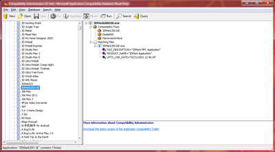

Patch for 3D Mark 2001 SE done so it can run via dgVoodoo as well: 3D Mark 99 Max & 2001 SE Startup Hang Patch
On 6th test, it throws this error: P_D3D::DRV_allocateMap - device does not support bump normal maps
Also, Windows applies some compatibility workarounds to the executable to prevent it from crashing as apparently the program does something ugly. One of those fixes is apparently the one that limits number available of available resolutions, so when run via stock d3d8.dll, only first few resolutions are available. Would be cool if someone figured out a patch to make it run flawlessly without those compatibility workarounds.
101.25 KiB
2248 views
