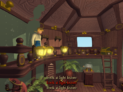

Reply 3900 of 3949, by KainXVIII
Buggy shadows in Escape from Monkey Island with latest version (even without resolution forcing)..

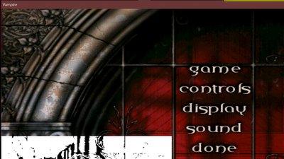

Reply 3901 of 3949, by Srtest
Hello.
Using latest wip (switching to the official ver doesn't help), I get this white garbage in Vampire the Masquerade - Redemption (also effecting in-game rendering) whenever I use dgvoodoo. I can get the game to work without it only that some time ago I had much better results with using it and using the driver straight-up doesn't work that good and sometimes not at all. This happens when I use 16 bit texture bit depth because 32 bit doesn't work at all with dgvoodoo.
I'm playing on an AMD R9 380 with driver ver 19.2 and the only thing inside dgvoodoo which helps technically but not really as the framerate is horrible is switching to warp on the driver level. I have tried any config possible and it doesn't change anything about this (including in the amd driver).

Reply 3904 of 3949, by antrad
I have a weird problem with Escape From Monkey Island with version 2.55.4. When I force resolution to 1280x960 and set centered scaling the framerate drops down to 36. It's nothing game breaking, but it's weird. I have not noticed any shadow issues though, but I only just got to the second island. (Windows 7, AMD card).

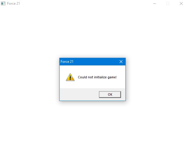

Reply 3905 of 3949, by Arklay
Force 21
with dgv2: "Could not initialize game!
without dgv2: black screen with music
inside f21 log
"It is not possible to create a D3D window with a hardware DirectDraw device. Check the mIsPrimary flag before calling D3DAppWindow.
InitializeRenderer() failed.
Display::Initialize() failed."

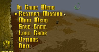

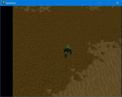

Dominant Species
with dgv2: only in game screen without menu, black bar in the left screen
without dgv2: only in game screen without menu, black bar in the left screen
insiede the ds log

Reply 3906 of 3949, by ZellSF
ZellSF wrote:
Force 21 works perfectly with resolution forcing (usually limited to 800x600), but I had to hex edit the main exe to point to dgdraw.dll and rename dgVoodoo2's ddraw.dll to dgdraw.dll to get it to work.
Since Dominant Species uses the same engine, you'll have to do the same. Both those games definitely work with dgVoodoo.

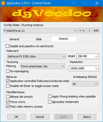

Reply 3907 of 3949, by Arklay

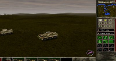

Thanks, only F21 has a "problem" with a pink arrow, it can be removed with "GeForce FX 5700 Ultra" setting. Fast Video Memory Access has been selected for the ati white textures bug.
    55.59 KiB
    2530 views
    341.05 KiB
    2530 views
    dp ok
    270.49 KiB
    2530 views
    f21 pink arrow
