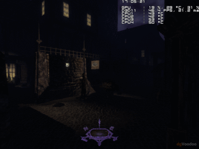

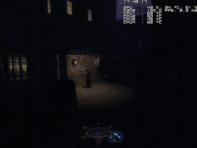

lowenz wrote:
Thief DS: http://s16.postimg.org/8ewfgzu29/T3_Main_2015_11_30_13_35_29_703.png […]
Thief DS:
Deus Ex IW:
Thief DS goes ingame if you didn't notice:
123.73 KiB
3123 views
Sort of annoying to get to though: the mouse cursor is invisible in menus.
