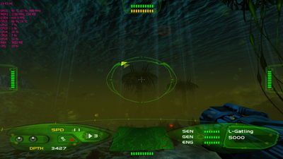

Vegetation in Aquanox is visible now but there is still something wrong with the radarmap.
What's the difference? 😀
As if native one was waving. 😀

With dgVoodoo there seem to be several map "layers" visible at the lower edge of the map that are not there in native mode.

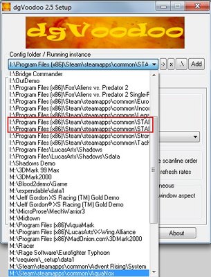

Would it be possible to make the width of the folder list adjustable? Currently really long paths can be a problem.
