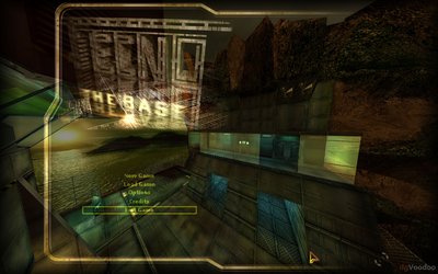

Tested the following with WIP24:
  • RiftSpace - In-game menus run at 30FPS, but in-game slows down to 20FPS, down to ~7FPS when using menus overlaid on the main 3D view. (This is a DX7 game, contrary to the official requirements.)
  • Lost Valley - the game runs, but audio-only. (A Multimedia Fusion game.)
  • The Desolate Room - same as Lost Valley. (Another Multimedia Fusion game.)
  • Ark 22 - runs with dgVoodoo2 just fine, but audio-only when resolution is forced. (Pre-YoYo Games "Game Maker" game AFAIK)
  • TECNO - The Base (free version 1.3) - runs great...but the mouse likes to leave the window, which causes the window to minimize when I click on what I think is the game window, which, depending on the game section, causes the 3D elements and/or certain GUI elements to no longer render when the game goes fullscreen again. Not sure how much can be done with the program focus issues (sounds to me like an issue with the game's handling of multiple monitors).
  • Tiger's Bane - doesn't use dgVoodoo2 when windowed, but when fullscreen, it uses it just fine and runs great! (Didn't test resolution forcing, though.)
Attached to this post is a screenshot from TECNO using dgVoodoo2 and my monitor's native resolution, with 8x antialiasing forced via dgVoodoo2's config program.
Also, out of curiosity Dege, what are you doing for antialiasing when it's forced via the config program? From what I can tell, whatever AA method you're using is stronger than both NVIDIA and AMD/ATI's forcable AA methods, yet provides remarkable image quality.
    366.12 KiB
    3410 views
Legacy MSAA that the DX API offers. It differs from the post-processed ones that can be applied through driver control panels.
