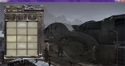

Reply 2951 of 3949, by kevsmudge
I'm getting lighting problems in Syberia 2 not seen in Syberia 1, also the menu does this wierd flickering where it shows certain tiles as
solid blocks of white that seems to be the texture from the main menu buttons.
I'm using the steam version atm but it's currently free on origin
https://www.origin.com/gbr/en-us/store/free-games
if they've updated anything between versions, apparently they added russian language support not seen in the steam and gog releases.
    236.88 KiB
    3336 views
    215.75 KiB
    3336 views
    224.08 KiB
    3336 views

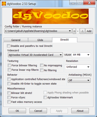

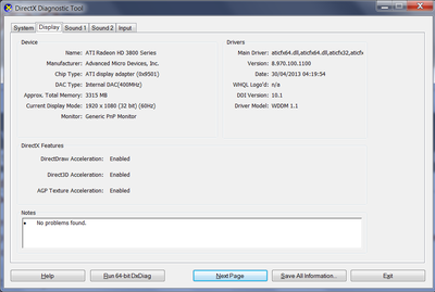

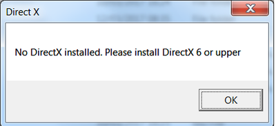

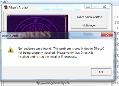

Reply 2955 of 3949, by jpp
I recently downgraded my gpu from Nvidia Quadro 4000 (fried) to AMD Radeon HD 3800.
dgVoodoo 2.53 does not work after the upgrade - can't detect the gpu at all.
Radeon HD 3800 is fully dx 10.1 and Shader Model 4.1 compliant.
I'm running Win 7 sp1 64 bit, everything worked fine with Quadro 4000.
Here are some screenshots:
    75.38 KiB
    2877 views
    dxdiag
    24.36 KiB
    2877 views
    darkstone
    82.91 KiB
    2877 views
    aiken artifact

kevsmudge wrote:
I'm getting lighting problems in Syberia 2 not seen in Syberia 1, also the menu does this wierd flickering where it shows certai […]
Thanks, I fixed that.
jpp wrote:
I recently downgraded my gpu from Nvidia Quadro 4000 (fried) to AMD Radeon HD 3800. dgVoodoo 2.53 does not work after the upgrad […]
The setup app detects DX10.0 or DX10.1? Or it says it's unavailable?
Also, does this issue come only with that game or with others too?

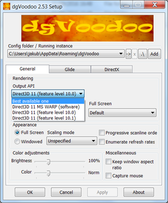

Hi Dege,
Detection works just fine, here are some screengrabs:
This problem happened with every game that I tried after the hardware change. Quality of AMD drivers software is abysmal compared to Nvidia.
I am running a fresh install of Win 7 64 bit SP1 + all the updates and Visual Studio 2013 Community,
Thanks for your reply
