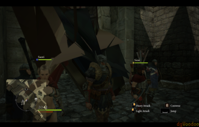

Here is Dragon's Dogma Dark Arisen working somewhat but as you can see, it has some issues. The game wouldn't even run at first if I didn't set the VRAM to a high value, otherwise I would get a 'memory overun' error box.
    1.43 MiB
    3927 views

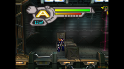

Rockman X7 (Korea-only PC version)
When using DGvoodoo, the game appears to blow up the size of 2D elements, such as the title screen or the game UI. I have never seen an issue like this before, only with this game. The actual rendering seems like it works like it should, though.

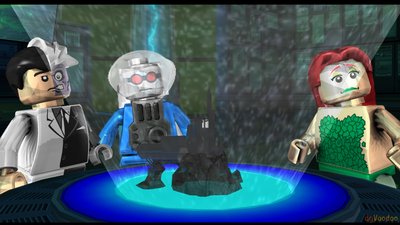

Lego BATMAN: The Official Video Game (DX9)
Works wonderfully with WIP57. It actually restores effects, such as bloom and DOF, which no longer work on my Win10 Home v1809 laptop with NVIDIA GTX 1060 Optimus graphics. However, the built-in ambient occlusion seems broken (see attachment), the game hangs for a few seconds on and off again, and forced anti-aliasing, while it works, tends to crash the game when it hangs.

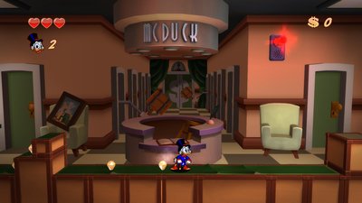

DuckTales Remastered
Issue with gems:
174.9 KiB
3554 views

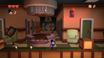

Original for comparison:
173.7 KiB
3554 views
Resolution forcing doesn't work, though I didn't expect it to as this game does internal scaling.

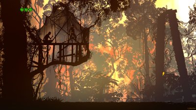

Outland
Not specifically to do with the latest WIP, but I found it in my screenshots folder and thought I'd mention that this game works. I don't think resolution forcing did though (it was unnecessary at any rate).

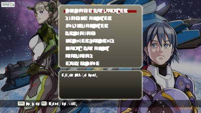

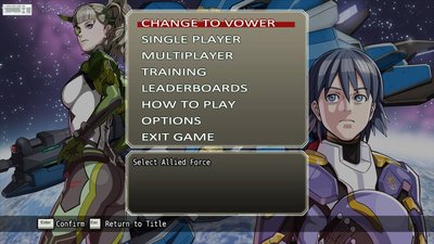

Strania - The Stella Machine
If you tested this you probably noticed, but thought I would mention it anyway, menus/in-game text are wrong:
155.32 KiB
3554 views
152 KiB
3554 views
I didn't except this to work with resolution forcing either, so seeing this 720p locked game render in 4K was a nice surprise. Performance was a bit too problematic for it to be playable though.
