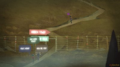

Oxenfree (x64, DX9)
Using WIP58 x64, only renders menus unless anti-aliasing is forced in config file. With anti-aliasing forced, all screen elements use bloom effect, including GUI and message prompts. This does not happen natively.
How can that be? It works perfectly for me. Do you get the same with the WARP driver? Or I have a different version of the game?

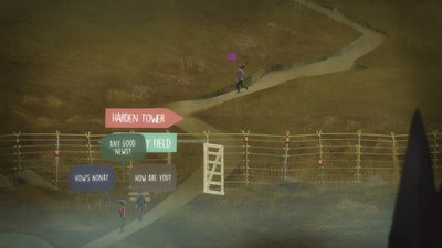

Reply 907 of 1111, by Expack3
Dege wrote:
Expack3 wrote:
Oxenfree (x64, DX9)
Found out what the problem with the rendering was: I tried manually inputting 4096 MB into the dgVoodoo2 config file for the game; using the config application to set the max of 2048 MB eliminated the issue.
That said, the bloom problem is still there, and there is, apparently, some issues with objects rendering.
Native:
320.06 KiB
3968 views
WIP58 (no modifications except 2GB VRAM):
319.94 KiB
3968 views

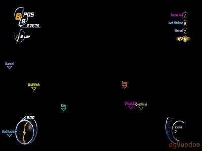

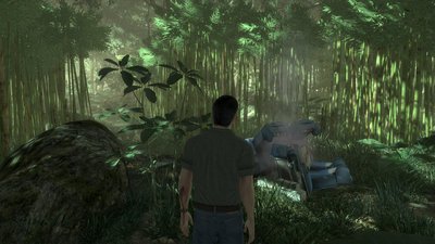

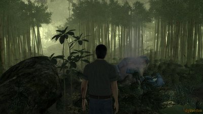

Lost: Via Domus
Not sure about this one, dgVoodoo2 seems to be both missing lightning and have more fog. It support shader model 4.0 (minimum requirement is 3.0), but considering the budget and mass market thing of this game, I sort of doubt important effects would be shader model 4.0 only (considering the release date). Native:
307.98 KiB
3647 views
dgVoodoo2:
235.72 KiB
3647 views
Requires messing with DefaultEnumeratedResolutions/ExtraEnumeratedResolutions or it will launch in 320x200.

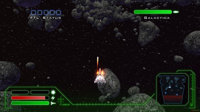

Star Hammer: The Vanguard Prophecy
Asteroids don't render properly, just blue.
