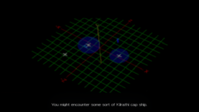

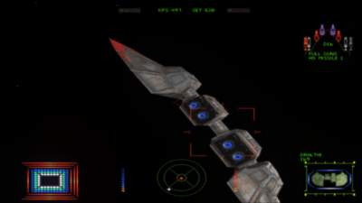

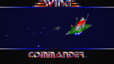

I never tested this game, so for the time being, I cannot say anything about the problem. I guess it's the usual GDI/DDraw interop which is currently not fully supported in dgVoodoo, that's why videos don't show up in many cases. Or they do, in wrong size (for example, they are too small, aligned to the top-left window corner, etc.).
i've also tested with the Kilrathi saga versions of Wing commander, all of them works perfectly with the DDRAW forks, though WC3 still has some CTD bugs.
1.16 MiB
986 views
918.63 KiB
986 views
691.45 KiB
986 views
im using reshade because its easier to take screenshots, but also to experiment with some of the effects
