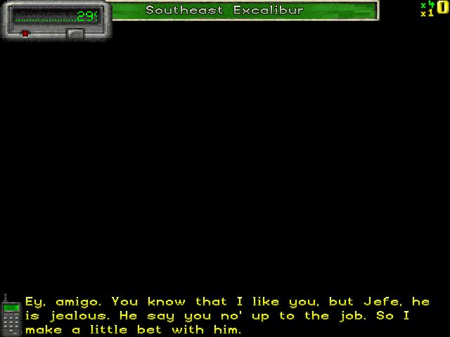

Hi!
I have tested "GTA" but only HUD is showing. When I change resolution ingame then all graphics are drawn. Also I tryed

Reply 81 of 341, by Zebius
Dege wrote:
Zebius, does it mean ATI-like rebooting? I'm getting discontented with nVidia drivers as well (as for new ones), even if crushing has nothing to do with them.
Hi! 😀
I just got black screen once, ctrl+alt+delete and other combinations didn't work so I had to reboot by pressing reset button. I messed with setings and had no crushes anymore. Just that W-buffering problem. If this W-buff auto-detect doesn't work in all cases maybe it will be better to add manual setting. I'm using Forceware 77.50, it's beta, but very good in all of my games.
    24.82 KiB
    6860 views
    And here is a screen from GTA demo on 1.40b, I tried different settings but still get the same black screen, as I said 1.31 works fine.

Reply 85 of 341, by Flint Eastwood
Hello!
@Dege
Zebius has made a wonderful shot of GTA. This is the same screen I got.
HUD means Heads Up Display that shows Health, Score, Ammo and so on...
Sorry for that shortcut. Please read the post I write here for Zebius. It may be also interesting for you.
Thank you for taking an eye on archimedean dynasty, it makes me hope(With Glidos I never came into a mission 😉 ).
@Zebius
You're right on Archimedean Dynasty. On my GeForce PC I first had Win98Se and DGVoodoo 1.31 and I found that some missions were playable and the graphics were very fine. Some other missions crushed on loading. I had to use server mode and didn't hide the console to get so far(sorry but I don't remember all the settings). But now since I'm using WinXP I get only the HUD and the rest is black(Using VDMSounds Nolfb and Mouse2kv helped to get so far, the VESA Support of dgvoodoo seems not working on mission-loading).
I have seen your GTA screenshot. Try pressing F10(or F11? 🤐 ). Then you can change the resolution of the game. This helped me. Surprisingly all graphics were drawn then.
I'm sorry but I have not testet TR1 with 1.40b yet. 😦 But I will do this soon. 😀
Ah, thanks. I tried out GTA again on GF5700, and it worked properly in each case (I experimented with VDD vs server mode in 16/32 bit, using/not using texture tiles, etc). I'm going to try it with ATI, I hope I can reproduce that bug. Could you sent me what setting you are using, plz?
