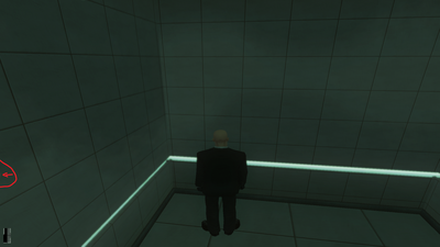

I'm currently playing Hitman Contracts with dgVoodoo and I've noticed a line (kind of flickering a bit) on the left side of my monitor. Is there any way to get rid of that? I remember it happening in some games (Oblivion, Kingdoms Of Amalur Reckoning, The Witcher 2) when anti-aliasing was on, but I haven't enabled it for Hitman Contracts. Edit: screenshot of the line. It moves upwards/downwards and as small as it looks, it is visible easily when playing the game.

Geez sorry I must be blind. They are not there (the black pixels), I only thought they were there because of a thin black stripe but it doesn't increase/decrease, definitely NOT by 16 pixels. Also the flickering line is at the edge of the black frame.

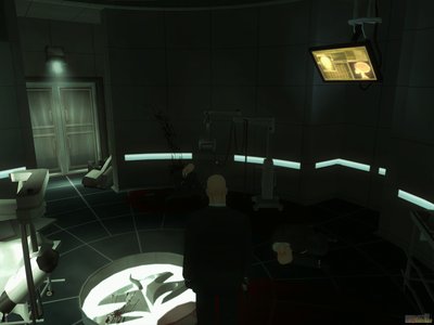

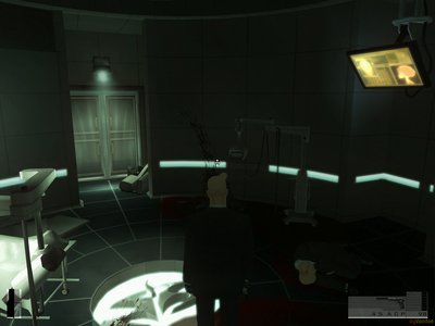

So since I was curious, I tested this. Hitman Contracts have those lines, but it's not a fault of dgVoodoo; the lines are there when rendering natively.
dgVoodoo's deframer still works though, but you need to force some other resolution in dgVoodoo, and if you have a high/mid resolution display you really should, it has terrible UI scaling:
489.57 KiB
705 views
512.52 KiB
705 views
If you're at a 1080p monitor you might just want to do 2x resolution force though. And if you don't have the hardware for that, antrad's solution is probably better. No need to mess with any custom shaders though, as ReShade has a border shader built-in that will work just fine.

It doesn't work. I tried forcing resolution through dgVoodoo and the deframer covers NOTHING.
Reply 15 of 15, by ZellSF
I thought you gave up?
At any rate, try deleting the config file and recreating it (to make sure a version mismatch isn't messing up parsing) and ONLY edit dgVoodoo.conf (don't use dgVoodooCpl) and try to set "Resolution = 2x" under [DirectX] and "DeframerSize = 16" under [GeneralExt].
Also check for the watermark, to make sure dgVoodoo is actually loaded.
