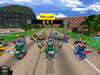

It's a resolution enumeration issue. You can right click a tab in dgVoodooCpl.exe and click "Show all sections of the configuration", go to the DirectXExt tab and set Enumerated resolutions Defaults to "Classics".
Or you can just install the patch:
https://www.patches-scrolls.de/patch/2268/7/45600/download
494.76 KiB
1009 views
Resolution forcing and MSAA works, game has bad UI scaling by default and is limited to 800x600.

Awesome, thankyou so much for this!
