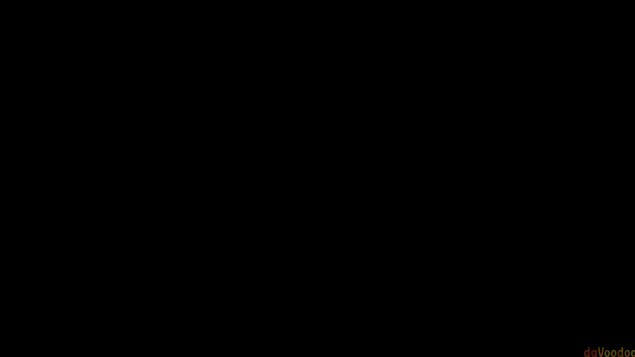

Reply 17 of 340, by lowenz
🤣, there's the logo! It seems that the resolution is not correct!
Maybe 'cause I have VSR (3 more resolutions) enabled? In D3D11 there's no problem at all
Reply 18 of 340, by lowenz
EDIT: No, disabling VSR doesn't change anything
Reply 19 of 340, by lowenz
Your (still needed) "SplinterCell3_1.05_dgVoodoo_patch" got the logo position corrected AND the black screen gone too! 🤣!
